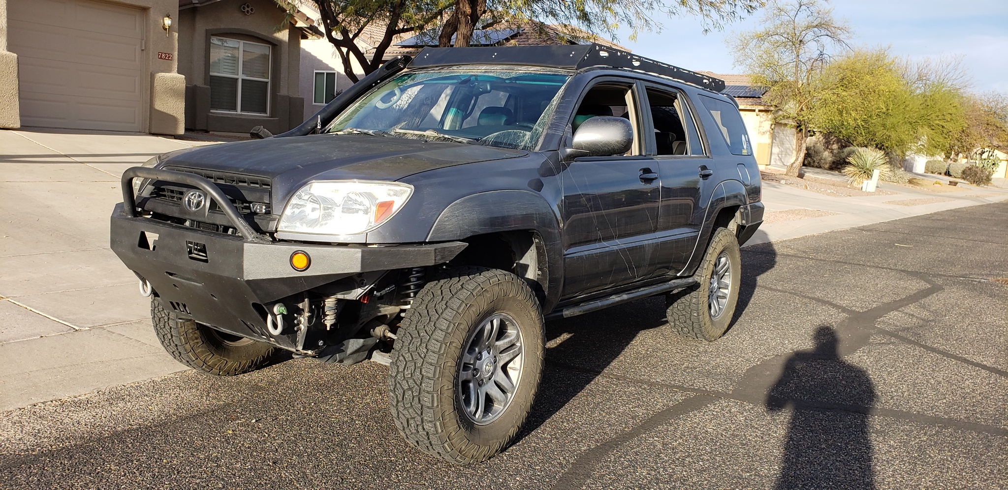

I'm a huge fan of the spray can bedliner from Harbor Freight. Front bumper, roof rack and sliders are all painted with that. Both bumpers and slider on my previous 99 Tacoma were painted with it as well. It holds up extremely well, is super easy to touch up and there is no blending needed. Usually, once it's dry, you can't really tell where the touch up was even done. And it fills in small imperfections or paint ships very easily and nicely.
$7 a can, not too shabby I don't think.
