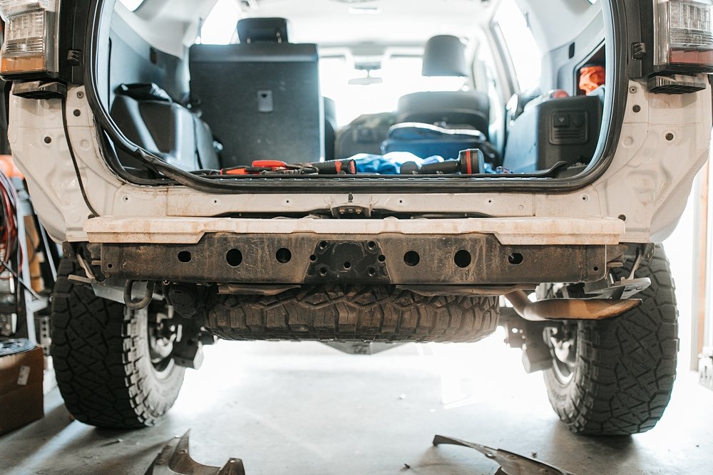

REMOVAL OF STOCK BUMPER
Coastal Offroad Low Profile Rear Bumper Review & Install For the 5th Gen 4Runner: Remove Your Stock Bumper
Really, the first step when getting started is to remove the stock rear bumper. You need to remove the bumper first and drop the spare tire because 95% of the kit will be tacked onto the truck’s frame piece by piece.
I was surprised how easy it was to remove the stock bumper. I had never done it before and it only took a few minutes. Standard plastic pry tools, a drill, and a few sockets will get the job done easily.

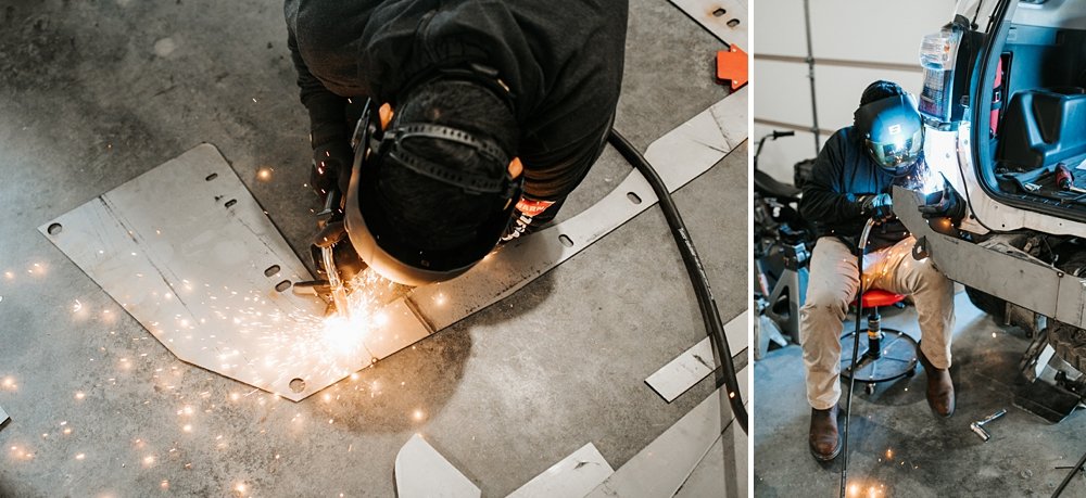

TACKING AND WELDING
Coastal Offroad Low Profile Rear Bumper Review & Install For the 5th Gen 4Runner: Tacking and Welding

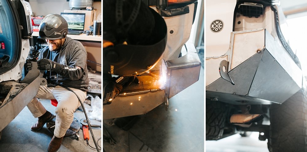

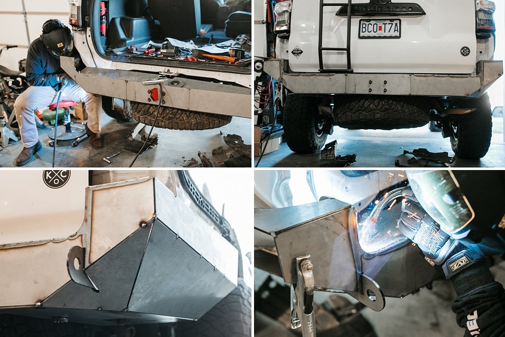

Huge shout out to my friend Luis of @4LOBound for doing all the welding for me! The welding process is where you will likely spend most of your time. It can be done by yourself, but you will be better served with a friend/helper that can provide an extra hand along the way.
The pieces are laser cut and, by default, they will keep fitment pretty precise. However, if working alone, the pieces can get heavy and still getting the angles right is a critical component to the fitment.
The process is pretty straight forward. Coastal Offroad provides step-by-step instructions as well as a fully numbered guide of pieces and their suggested order of assembly. With a DIY kit, you can kinda go your own way but keep in mind going your own way is going at your own risk.
A NOTE ABOUT HIRING A 3RD PARTY WELDER…
You can hire a 3rd party welder to do this portion of the job for you, however, be advised that this project really is a 2-day project and the bumper is assembled, tacked, and welded MOSTLY while it’s bolted on the truck.
If you hire a 3rd party welder, it’s likely that you will need to hang around their shop for a couple of days or plan on leaving it and coming back a few days later.
When hiring a 3rd party welder, make sure the welder is knowledgable with how to remove the OEM bumper and make sure you provide the various extra frame bolts that are required during the assembly process.

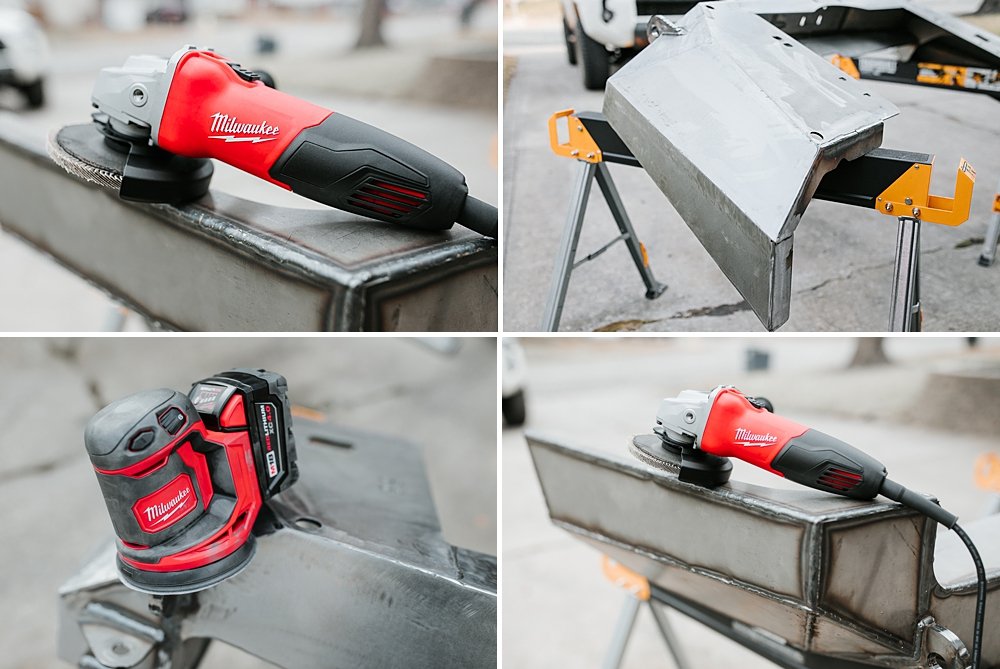

GRINDING THE WELDS
Coastal Offroad Low Profile Rear Bumper Review & Install For the 5th Gen 4Runner: Grinding the Welds
Welding is done and now it’s time to clean up those lines! I wanted a very seamless look to this bumper and Luis (my welder) gave me plenty of the weld to work with in order to grind down to that seamless look.
I spent somewhere around 6-8 hours grinding and even used a DA sander with a few different grits to get the fully-finished look I was hoping for.
Grinding did reveal a few small pinholes here and there but at the end of it I did decide to put a few stitch welds on the inside of the bumper just for added strength and peace of mind, so filled the pinholes and re-ground them at the same time.

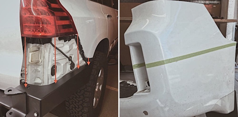

FINAL STEP: CUTTING THE BUMPER
The last part of the install is pretty simple. There are up to 14 bolt-on locations and I only used 12 of them.
Once you have the metal bumper bolted back on, be sure to close the liftgate and center up the bumper before torquing it all down. Recheck alignment after torquing it down.
Cutting the stock bumper can be nerve-y but its pretty simple. With the metal bumper fully torqued down, pull several measurements between the top edge of the metal bumper and the quarter-panel as well as the taillight.
Keep in mind, you can always cut more plastic but not vice versa! If you’re really picky like me and IF you mess up by over-cutting, you will be running to every junkyard in town looking for a fresh OEM bumper to start over. Don’t be that guy!
Once your measurements are pulled, transfer them to the un-cut plastic OEM bumper with a marker and create a straight line with masking tape for your cut. Once your cut line is created, pull all the measurements again just to make sure they’re accurate! Measure twice (or 6x in my case LOL) and cut once.
CUT ALONG MEASURED LINE + CHECK FITMENT
Coastal Offroad Low Profile Rear Bumper Review & Install For the 5th Gen 4Runner: Optional Rear Camera Re-Locate
Cut along the line with a Dremel. Once cut, check the fitment and make any extra cuts as needed for proper fitment. If you’ve never cut plastic before with a Dremel, practice a bit on parts fo the bumper that you know will be thrown away to get a feel for the speed, blade, and the cut process.
Note: You need to have a 1/4”-1/2” gap between the metal bumper and the freshly cut OEM bumper to allow for frame flex. During frame flex, your metal bumper may squish up into the remaining OEM plastic of the body and create damage IF your gap is left too tight/small.
Finally, finish off the cut plastic with plastic edge trim for a more finished look!

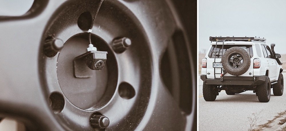

Once your bumper is all buttoned up, your OEM rear camera will be blocked and basically useless. I came across a plug-n-play rear camera relocate kit from RIGd Supply. For about $100 you can pretty easily restore your rear camera wherever you choose. I put mine on the spare tire mount.
The kit plugs into the dash at the OEM camera harness and it comes with enough wire length to run through the undercarriage to the rear spare tire.
The is a harness clip about 2’ from the end. In the event you run the camera wiring through the spokes of your spare tire, simply unclip the harness to create a loose end and you can slip the spare tire right off without any issue.

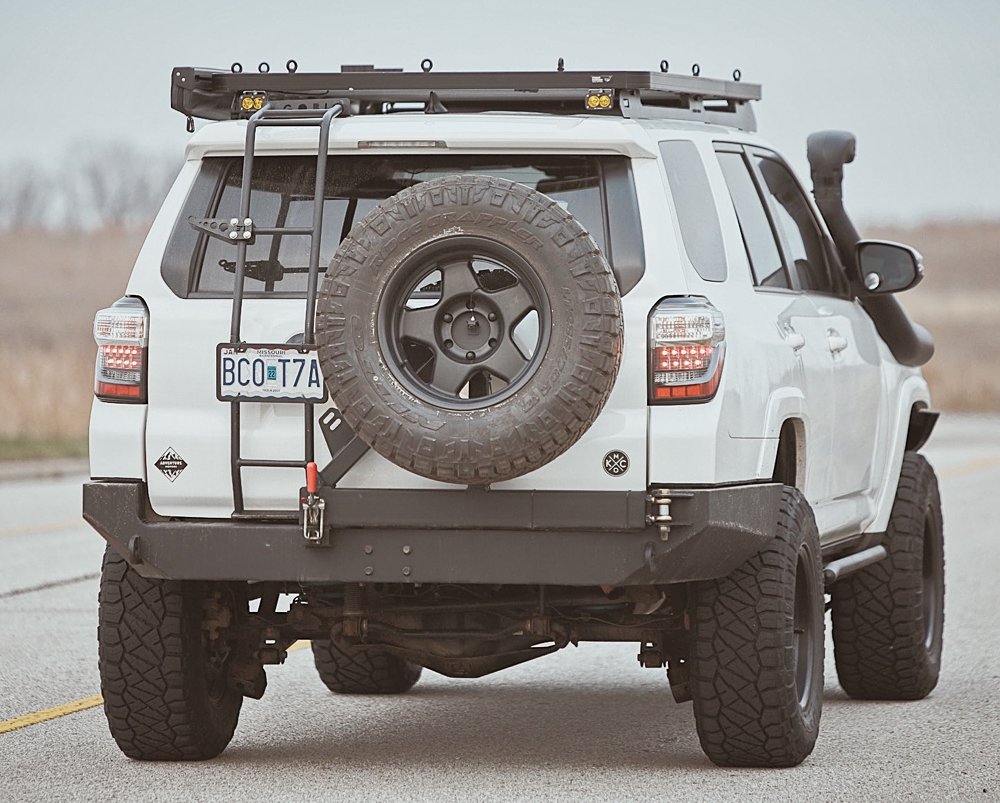

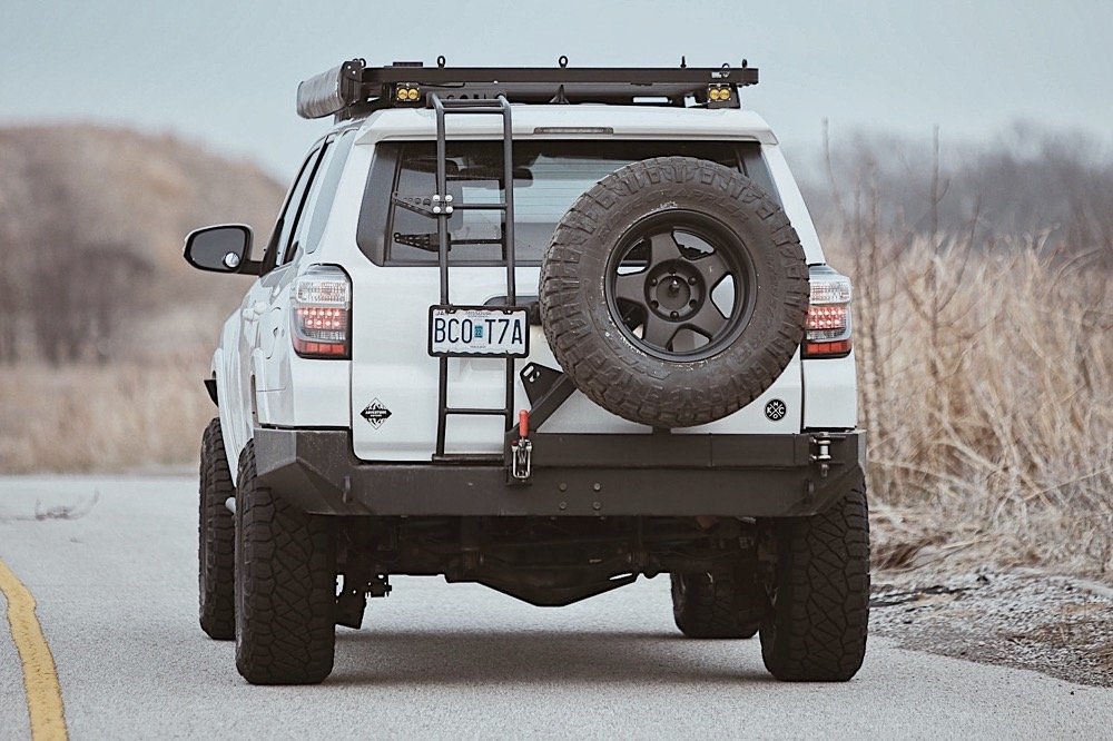

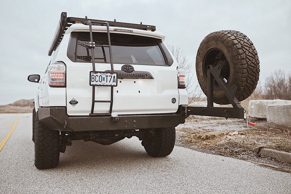

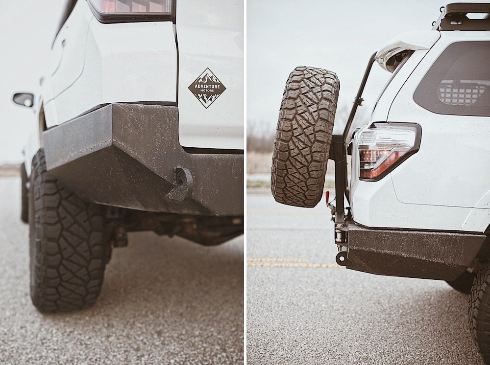

I’ve had this bumper on for 2 months now and I couldn’t be happier! I love the look and it had already taken some knocks and bangs in the Ozarks this past winter. I’ve already had to touch up the paint with Rustoleum Rust Stop. Gotta pay to play I suppose.
This bumper is quiet both on and off-road; no crazy rattles or shakes. Initially, my tailpipe hook was rattling against the bumper but that was an easy chop job which also created more clearance as well. Win-win!
I can’t stress enough how much I love the lines and fitment of this bumper. There’s not a whole lotta flash to the swing-arm and I love that. It is a fairly lightweight kit while providing maximum clearance and protection.
The way I have it set up is basically as tight as it can go to the liftgate. The heim joint leaves room for some micro-adjustment to the swing-arm if needed.
The beauty of a DIY kit is that you can really dig in and add in your own custom touches as well. I didn’t really add anything but I’ve seen users that have added Baja S2s and I’ve seen others add extra reinforcements in places. One could really get creative with a little bit of effort.

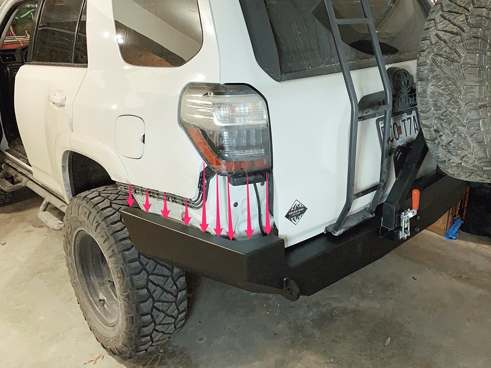

I built one a few weeks ago for my limited and added the quarter panel tubes for protection. I plan to knock out the swingout once the rest of my parts come in from RuffStuff. For those interested I sent them a pm on Instagram with a screenshot of my order on a Monday night. They sent me a coupon code and had it delivered to my haus that Friday afternoon. They are ridiculously quick to respond on Instagram and looking to bring new products to the market. They are working on a prototype for 5th gen skids as well, unfortunately I live to far to get on that list when I asked a few days ago.
thats rad, looks like you used their basic bumper and added your own swing arm joints and tubing? looks fun man.
Thats rad, looks like you used their basic bumper and added your own swing arm joints and tubing? looks fun man.
I redid their hitch as the way it is designed, it goes under the bumper too far to fit a stock spare after installing. Also this way saved me a few more inches of ground clearance over mounting it under the bumper.
I used some RuffStuff crossmember bushing kits I had laying on the shelf and whipped up some side gussets for the swing outs. Unfortunately their wheel mounting plate was back ordered and won't be here until the weekend, so I didn't finish the actual swing out portion just yet. They run a lot of sales, and you can get the parts cheaper than $500 for the Coastal kit.
