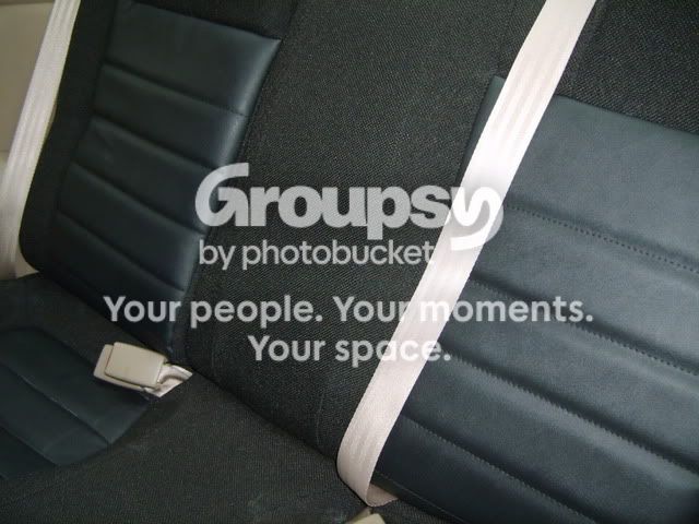

here is the back seat i did to my civic a long time ago, kinda cool i did a tweed with a vinyl pleats.
After2.jpg~original
