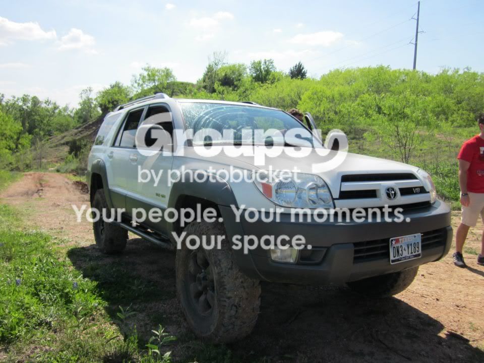

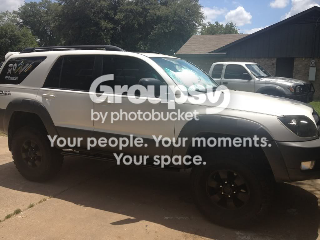

I used to have 885's with SuperFlex and a V8. It sat like this...
Thanks for the input! I almost bought the 895e springs. I'm gonna go with the superflex coils instead.
