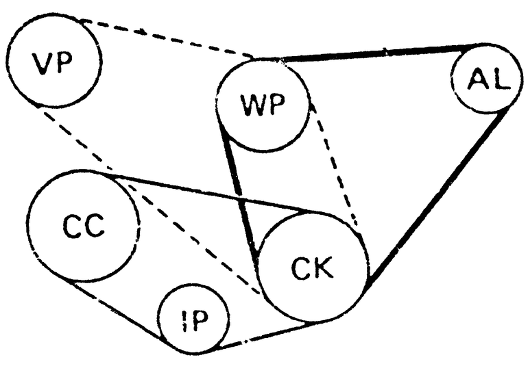

OK i want to change all my belts but there are three belts and im having a hell of a time figuring out where to start. I can
For the power steering drive belt, loosen the nuts and bolts on the mounting brackets for the pump (VP = vane pump = power steering pump).
For the AC (CC = cooler compressor) drive belt, loosen the idler pulley.
For the alternator drive belt, loosen the mounting nuts and bolts on the mounting brackets.

thanks I'm used to a single tensioner pulley and a single belt the three belts left me going wtf so thanks for the simple instructions and the diagram.
