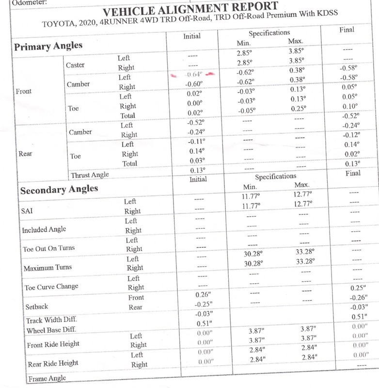

one of the dealers did give me a print out..............i will post it....

https://i.postimg.cc/Ghb5m9tW/4runner-results.jpg
The section marked with red was after the second alignment. Everything is within specs, tire swap and still pulls right.
What kind of tires did you get? I had ST Maxx's in the past and that caused a tire pull to the right. As soon as I got Ridge Grapplers the pull was gone.
Also, why are they not showing your caster results?

That alignment readout is a bit lacking, I would have liked to see at least Caster if not SAI. I wonder if that's just one of those alignment "quick checkers" we have a couple in lube bay and honestly aside from getting a rough idea of Toe, they tend to be a bit off on camber and caster. The wheel being set back a half inch made me wonder what the caster settings were as you can move the wheel around a bit by playing with that (it's one of the reasons a lot of people will opt for 4° of Caster when doing lifts.)
