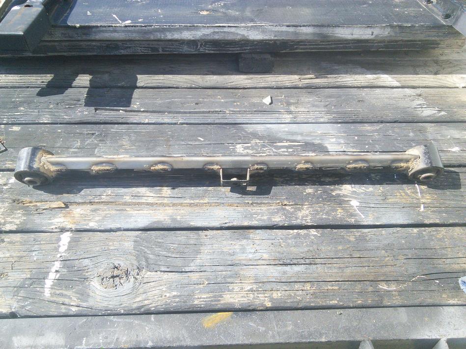

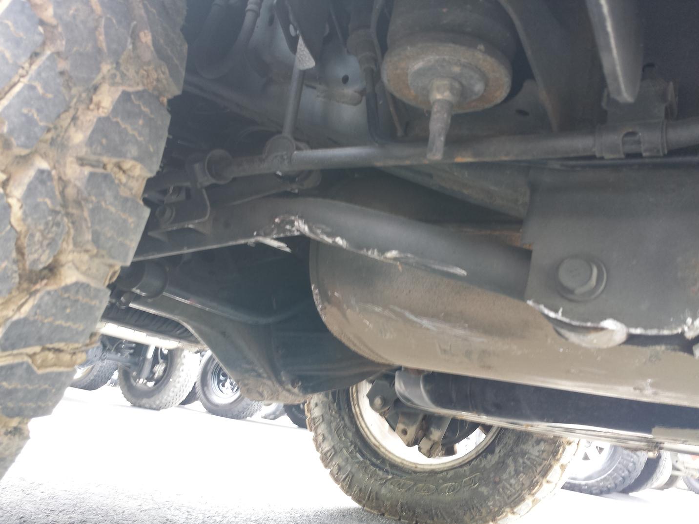

Took my 4runner over some rocks and my pass. rear lower control must have landed on a rock and bent it. Looks pretty simple to replace, but any tips? Can I just unbolt the old and install the new?
Also, the dealership is charging $208 for a new one. Are there any inexpensive aftermarket control arms?

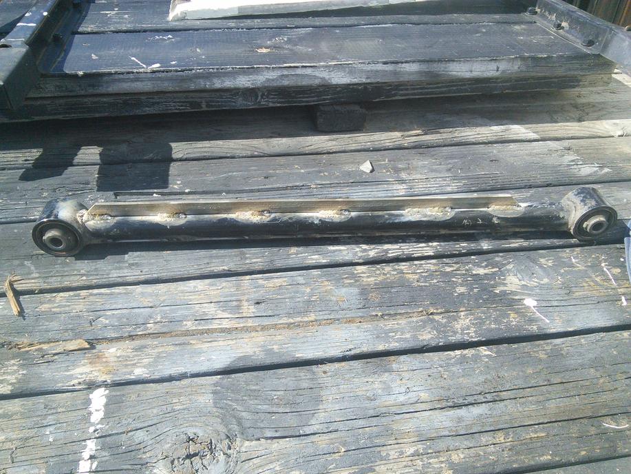

If you can get another stock set from a wrecking yard and can weld, you could do something like this.

Can the rears of these 4runners be aligned? I didn't see any cam bolts or anything for aligning. I'm going to get it re-aligned after I change the arm just in case it's now way off.
Your alignment is going to feel and is out due to the bent arm you have, you just changed the directional of the rear axle.
If you go with the metal tech, toytec, ect. That have the adjustable nuts on them, you can align the reader also as long as they are a good 4x4 alignment shop.
If you just get a stock replacement, you should be alright, but doesn't hurt to have it redone for piece of mine.
