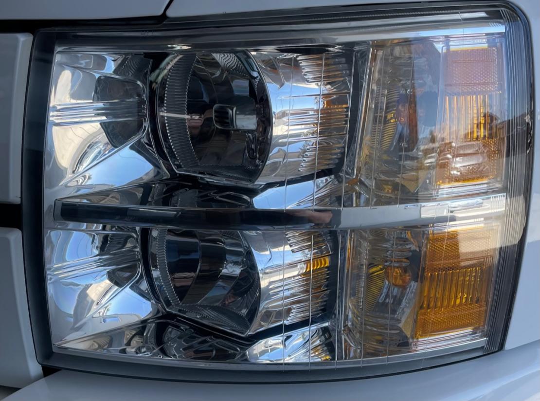

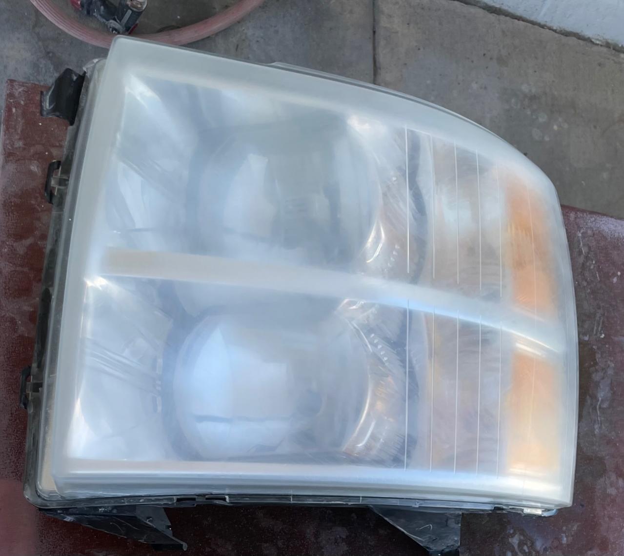

Wet Sand 1000 grit then Clear Coat. That's what we do at our shop. I thought there was more to it, but that's all we do.
1000 grit then clear coat before and after.
