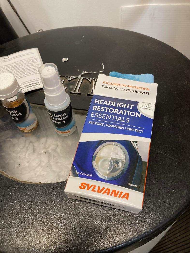

My ‘07 Sport’s headlights keep yellowing. I bought the Meguires headlight buffing kit years ago and about every 6-9 months the headlights will yellow again because of UV light. I have seen posts about spraying clear paint, but in the end it cracks and peels. So I didnt take that route. Did a search on the web. And youtube for the best restore kit and every kit requires sanding. My ADD doesnt allow for that kind of effort. There is one kit that stood out with regards to longevity and that was Sylvania. The final coating is a UV protectant and had good ratings albeit informal youtube experts. So here we go.

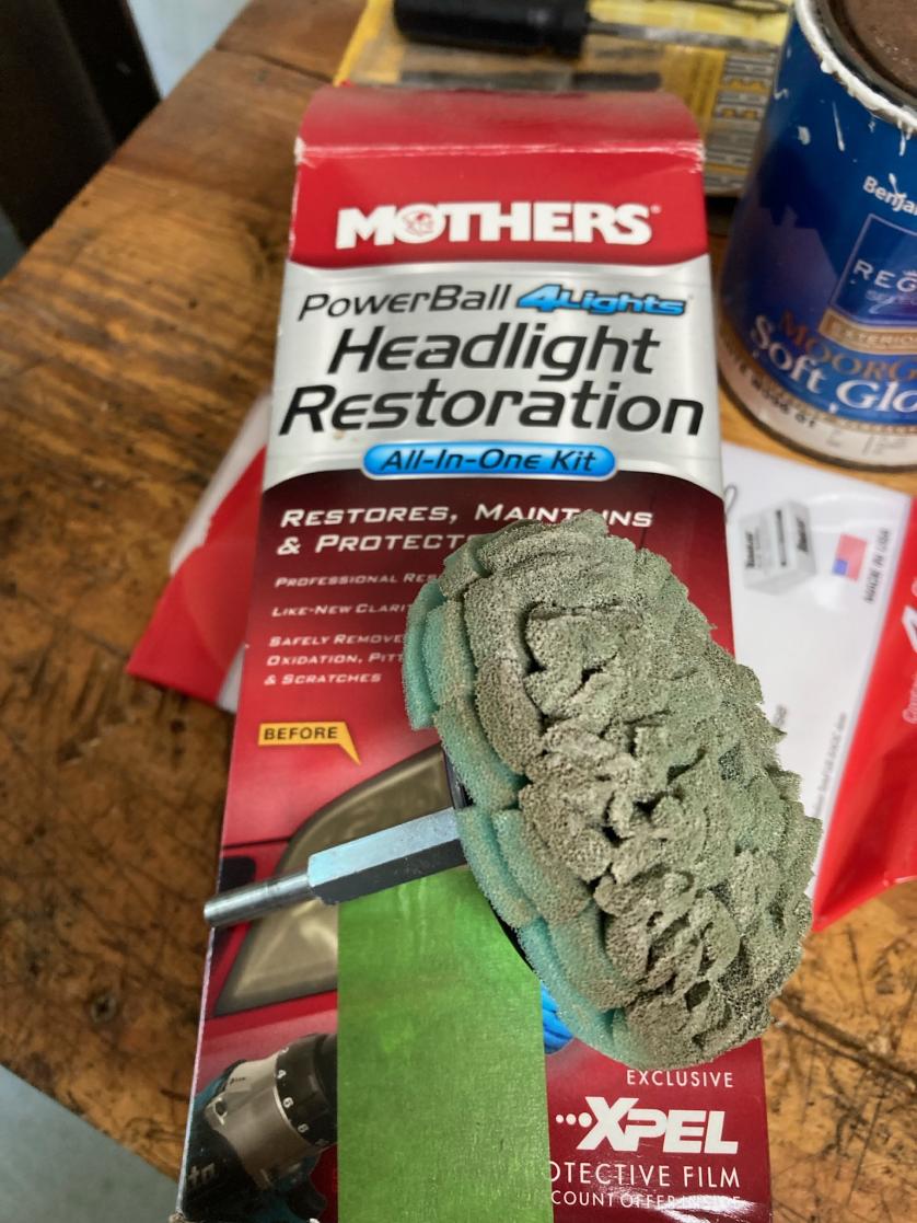

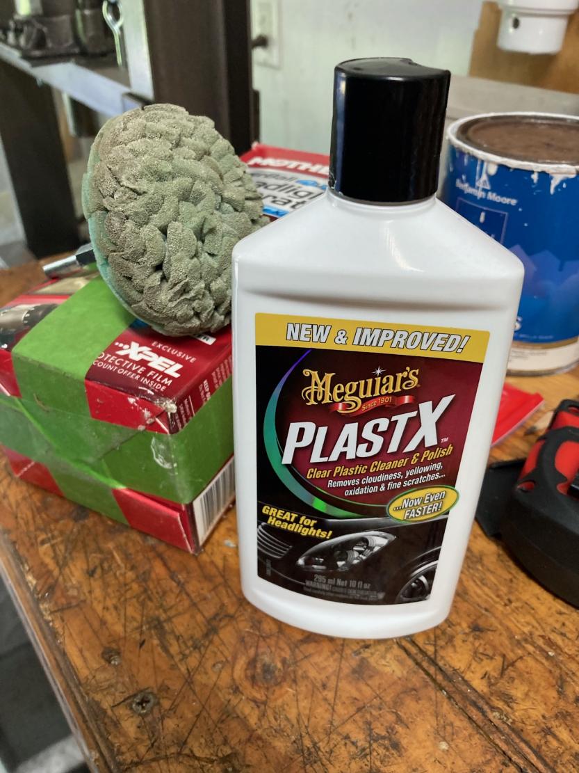

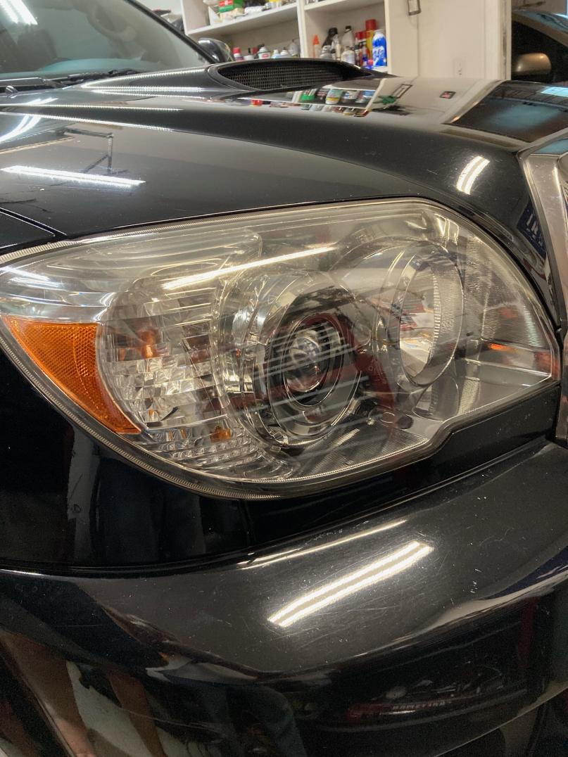

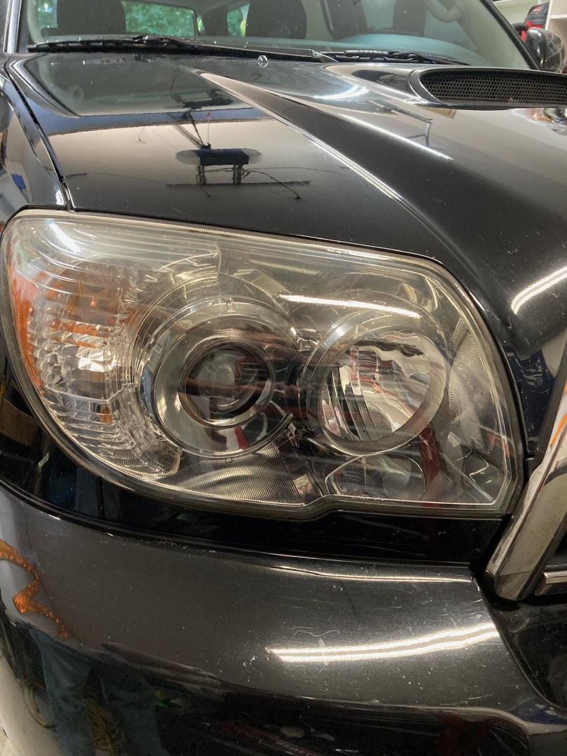

I used the foam ball included in the Meguires headlight restore kit in my cordless drill and used a new compound from Meguires “PlastX” to bring the surface smooth and remove the yellow haze. In short order, the lenses were clear again. I washed off any remaining compound and let it fully dry. Then skipping steps 1 & 2 of the Sylvania kit (1) softens the haze, (2) sanding. i moved to step 3 which is the UV coating. You soak a folded rag included in kit and wipe across from top to bottom keeping the rag fully soaked for a heavy coating. One coat on each lens. Let dry for 6-8 hours (overnight preferred) and its done.
I will post back over time with the results. Hopefully this is a once and done process. Sylvania offers a lifetime warranty, for what its worth.

They look great!

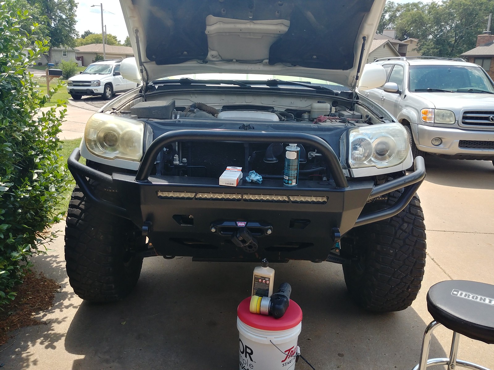

I've done they Sylvania kit a few times on a couple vehicles. When I upgraded to the 06'+ headlights I buffed the used ones I bought and used the Sylvania clear coat.
This is what it looked like after exactly 2 years. Left is unbuffed after 2 years, right side is freshly buffed (w/ light condensation in the housing):
The Sequoia behind it is roughly 3 years with the Sylvania kit. YMMV
