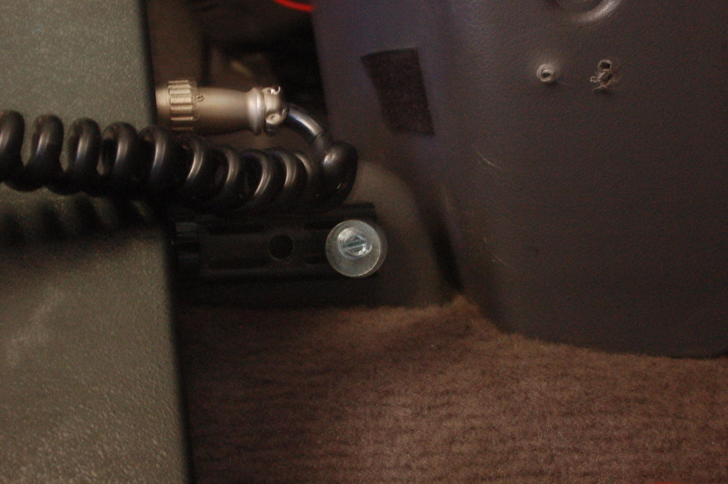

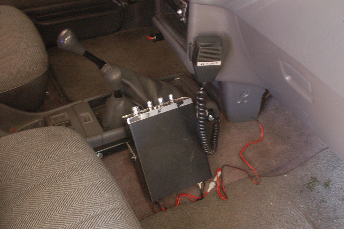

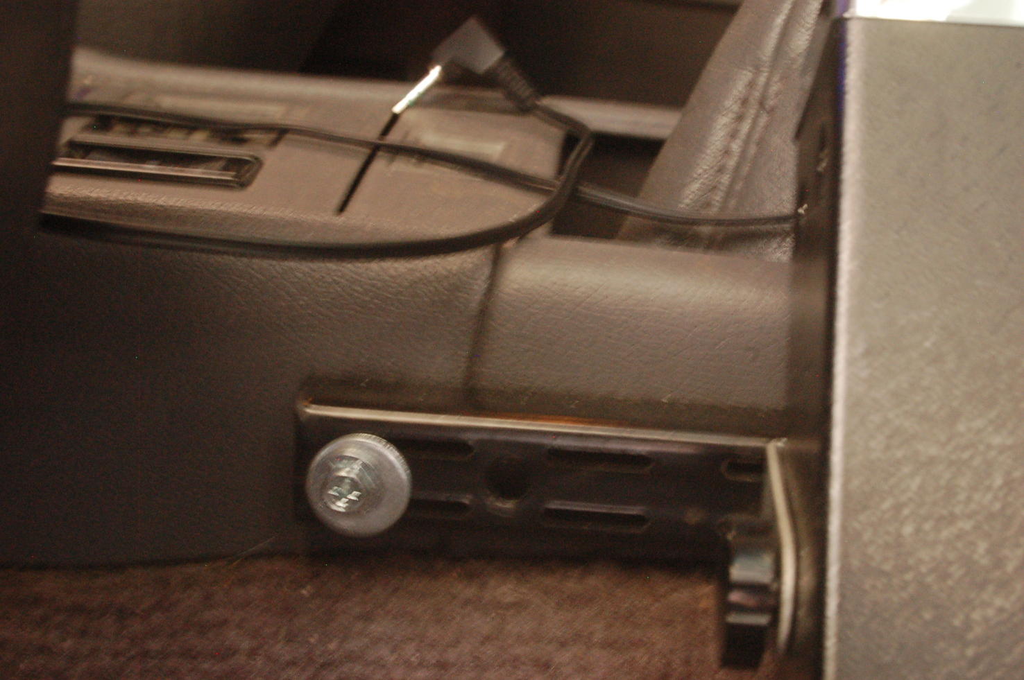

What I wound up doing was a little fabrication - using a piece of shelving bracket, I attached it to the passenger side of the shift boot plastic housing, using existing screw holes (which fastened to structural metal). I then attached the u-shaped mounting bracket with the CB (I scored a Midland CB in good condition from Goodwill for $4.99, but still need an antenna) and I was all set. I really should take some pictures. This would seem like it would be doable with many different years, depending on the fastening screw positions for the year in question.

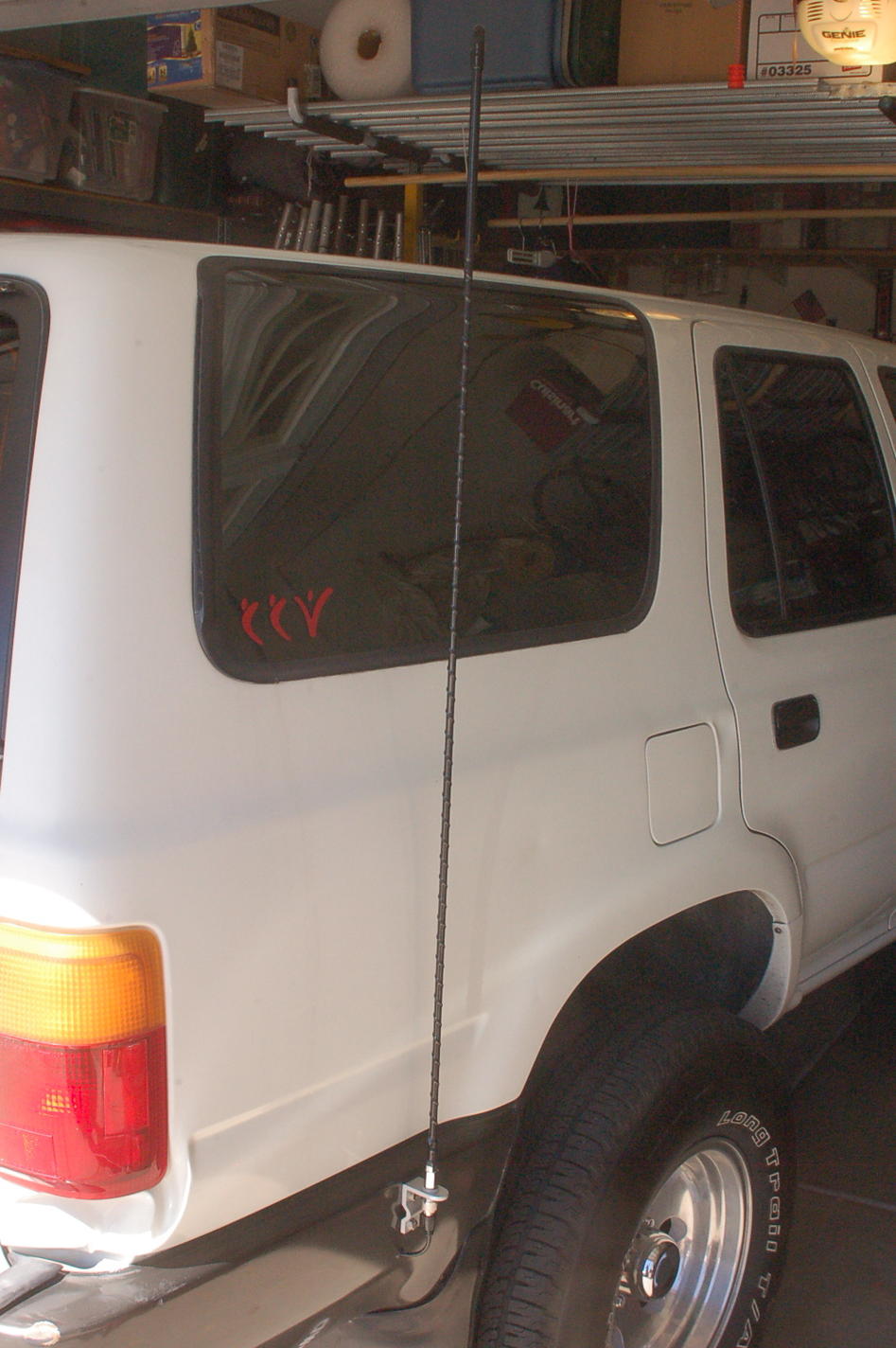

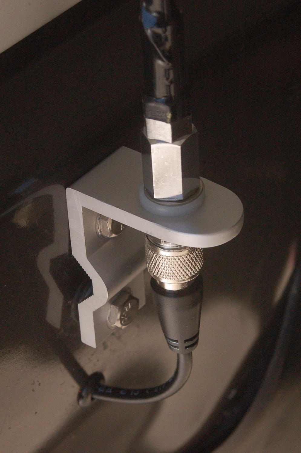

Here are some shots of the final CB installation. I used a piece of shelf bracket as an adapter from the side console mounting screw positions to the CB mounting piece. The antenna was a single truck CB antenna adapted to this position. Coax was run up through the boot decking and under carpet. Whole thing was tuned and peaked by Apollo Communications in Glendale, AZ. I apologize for the less than perfectly focused pictures. I hope you get the idea.
