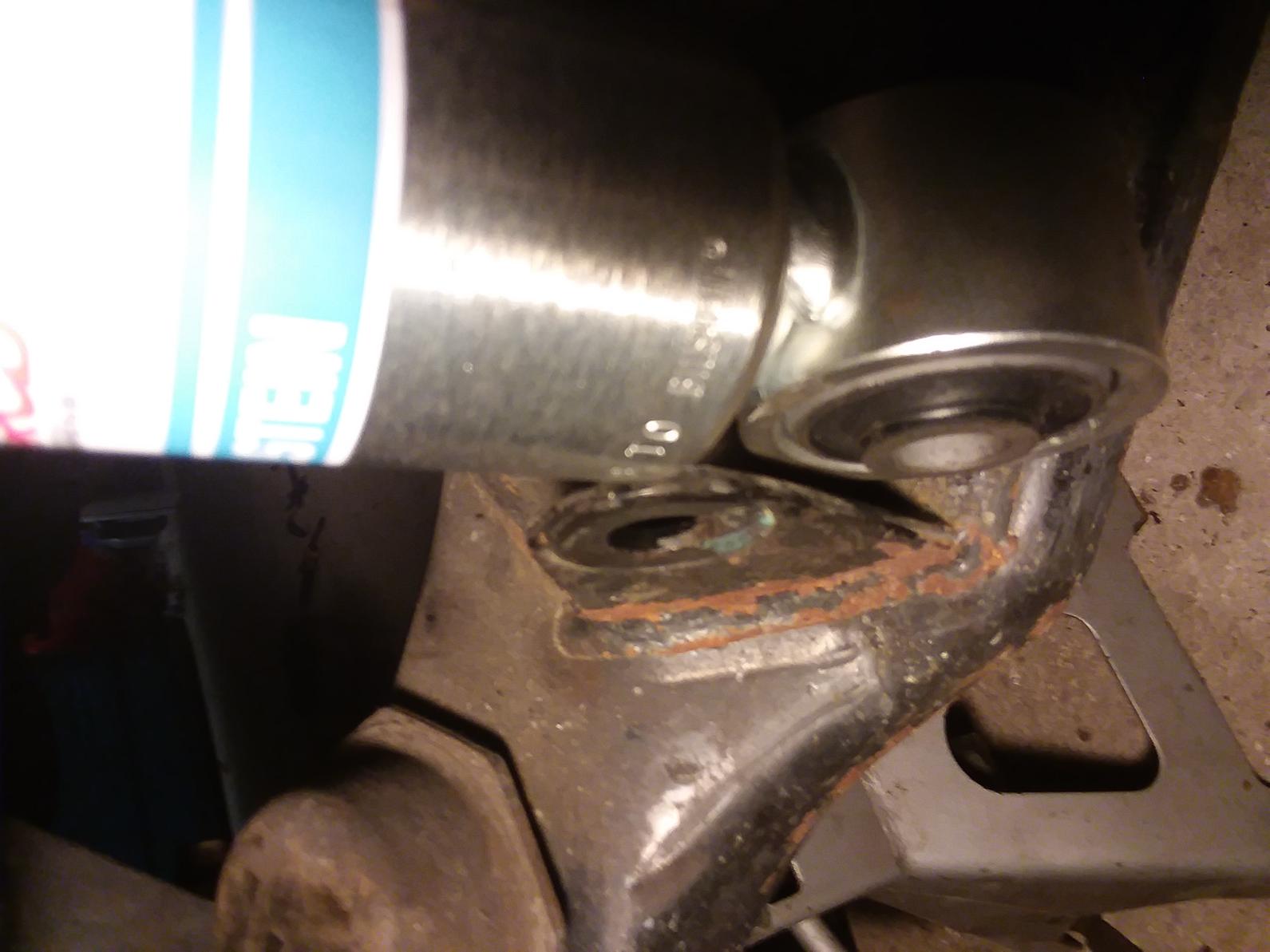

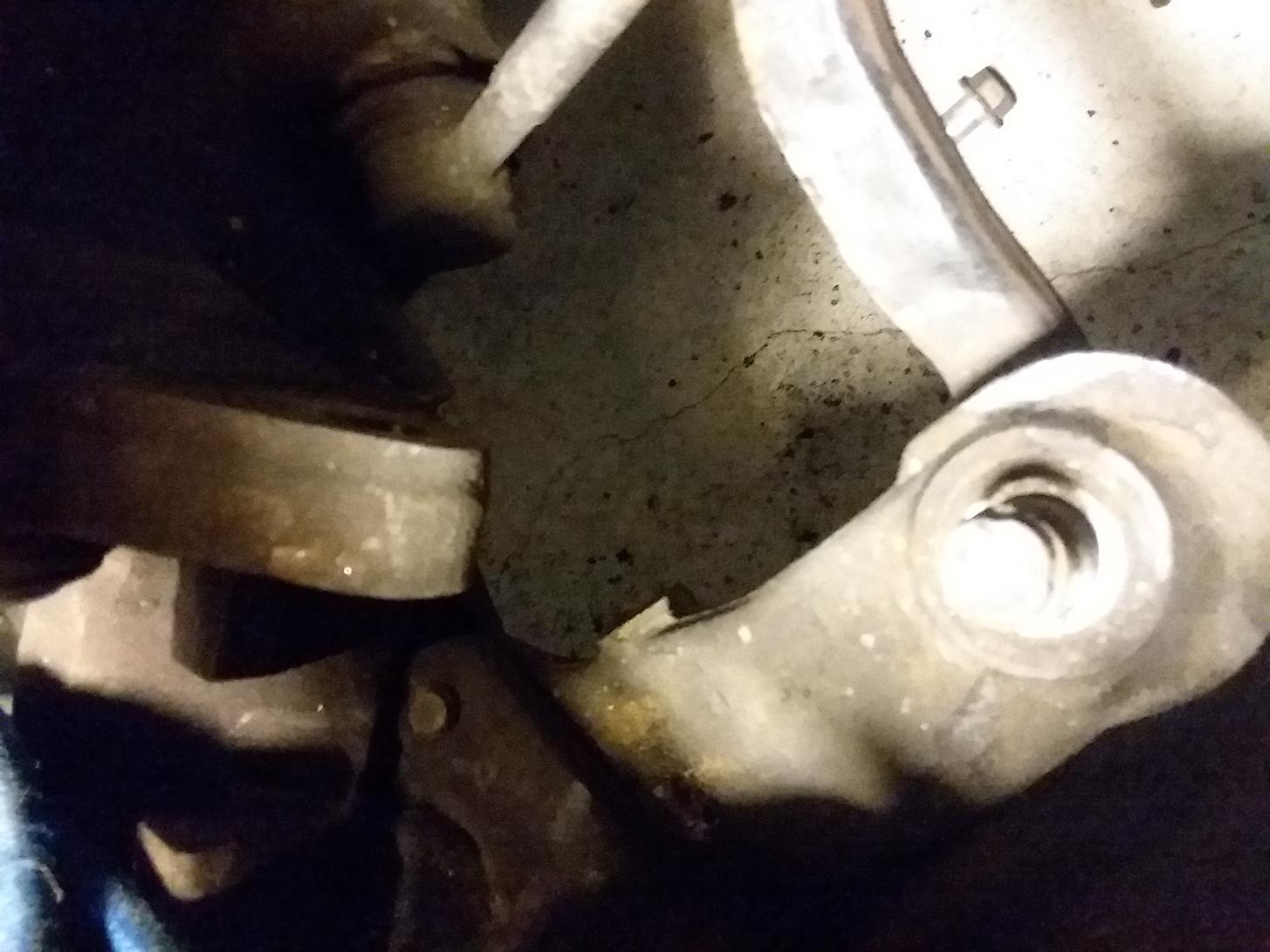

Hope I'm posting in correct section. I swapped out the original stock front shocks on my 2000 4runner SR5 with Bilstein 5100s adjustables and used the stock springs. I chose the highest setting on the Bilsteins of 2.5 inches and I can't figure out how to lift or what to loosen on the suspension to finish the install as I now need more room (2.5 inches) to install them. I've tried searching the forum but can't find the answer. Thanks in advance:ybrick:
Nothing on the suspension to loosen. You mount the top in the coil bucket and then you may have to pry the lower control arm down to get the lower bolt through the eye in the shock.
See attached pics. I'm using the handle of my 3 ton jack to pry the lower control arm and there is no way it's going to work. I akso loosened the sway bar at the wheel and no go. Maybe have to loisen up outer tie rod? Wondering if I have to adjust the setting on the shock to 1.5 or lower?

Piece of cake. Just find a pry bar or pipe to push the lower arm down more to squish the bumpstops more until you can get the bolt in.
What part number were the bilsteens that you us3d with your stock coils?
What spring/shock did you choose for the rear?
I’m looking at doing the same thing soon.
The shock extended length is the same no matter what the lift setting is.
You need a pry bar between the upper am pivot (next to the shock tower) and the upper arm. Push down on that, and the shock will fit right in.
Alternatively (and more correctly), you can loosen the two lower a-arm pivot bolts (adjusters) and the upper a-arm pivot bolt and the suspension will droop completely. From there, you will have to jack the lower arm back up to meet the shock. Re-tighten the upper and lower pivot bolts with the suspension at the new ride height.
