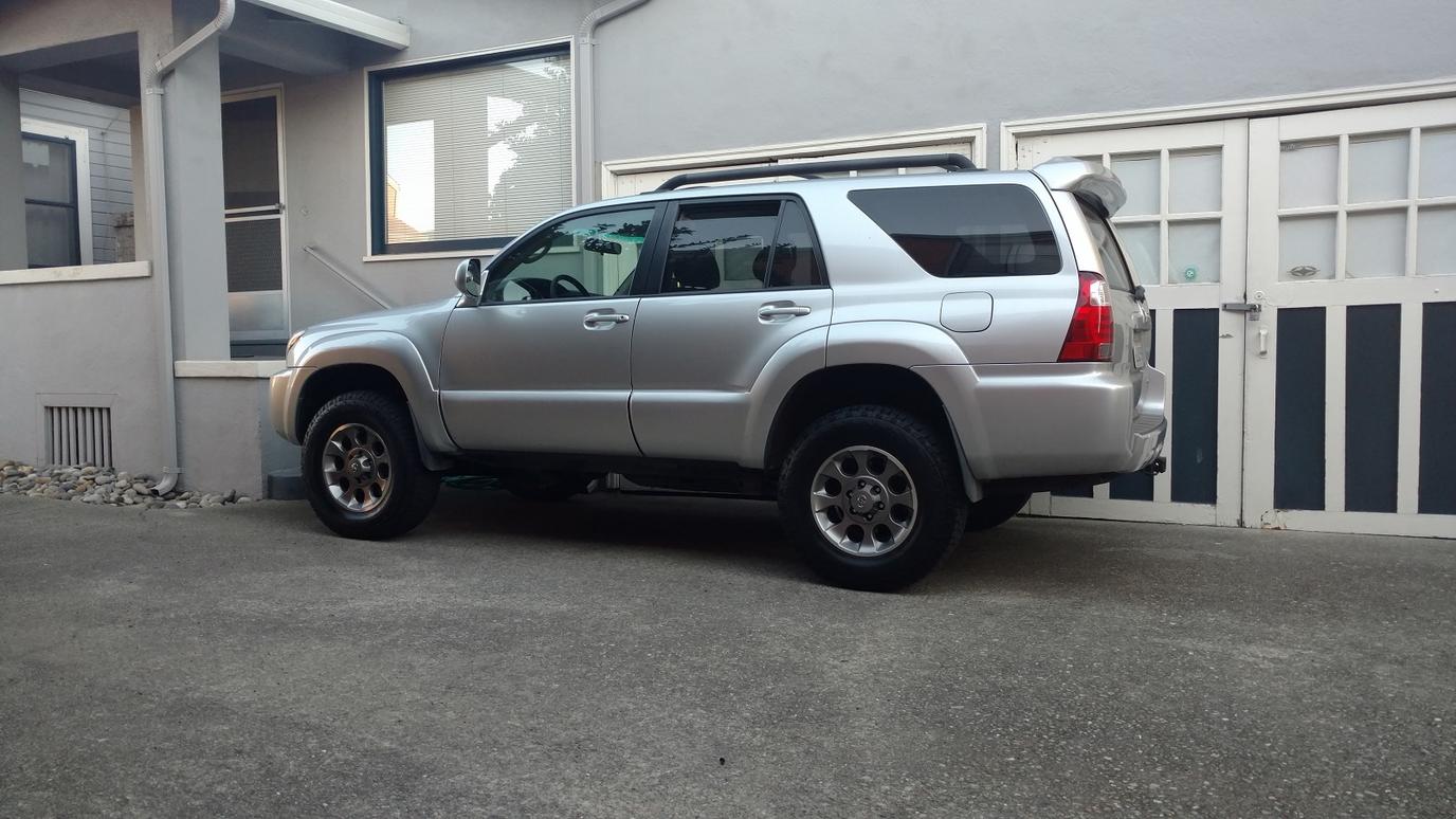

icon stage two using dobinson 323 rear coils in back 256/70/17 hankook atms
/\ perfect right there.
