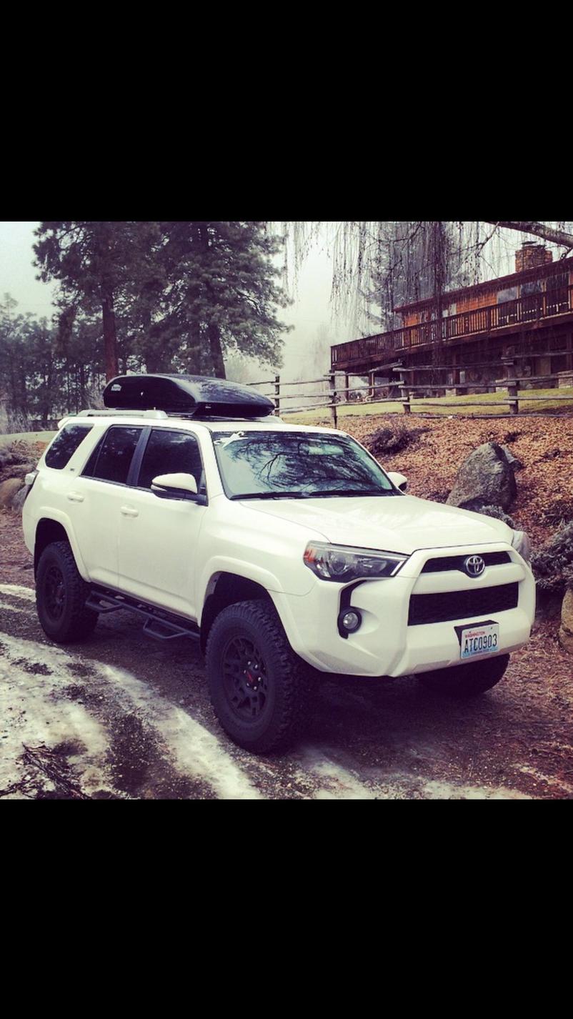

I'm looking to get a 40 inch light bar installed to go along with my new Gobi stealth rack and ladder combo... The stealth rack comes with a set up for a 40 inch bar...
My question is...
What is the best light bar for around $300-$750 and where is a good place to get it installed in the greater Seattle/Everett/Lynwood area?
I have a 2015 sr5 premium in white
Also is drilling into the roof or vehicle required for installation to hide wiring?
Any recomendatioms or thoughts on the light bar with Gobi stealth rack will be appreciated!
Thanks guys!
