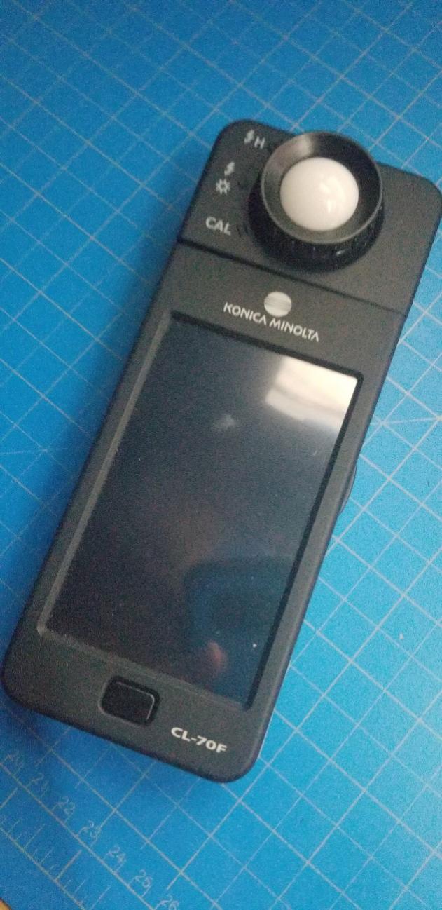

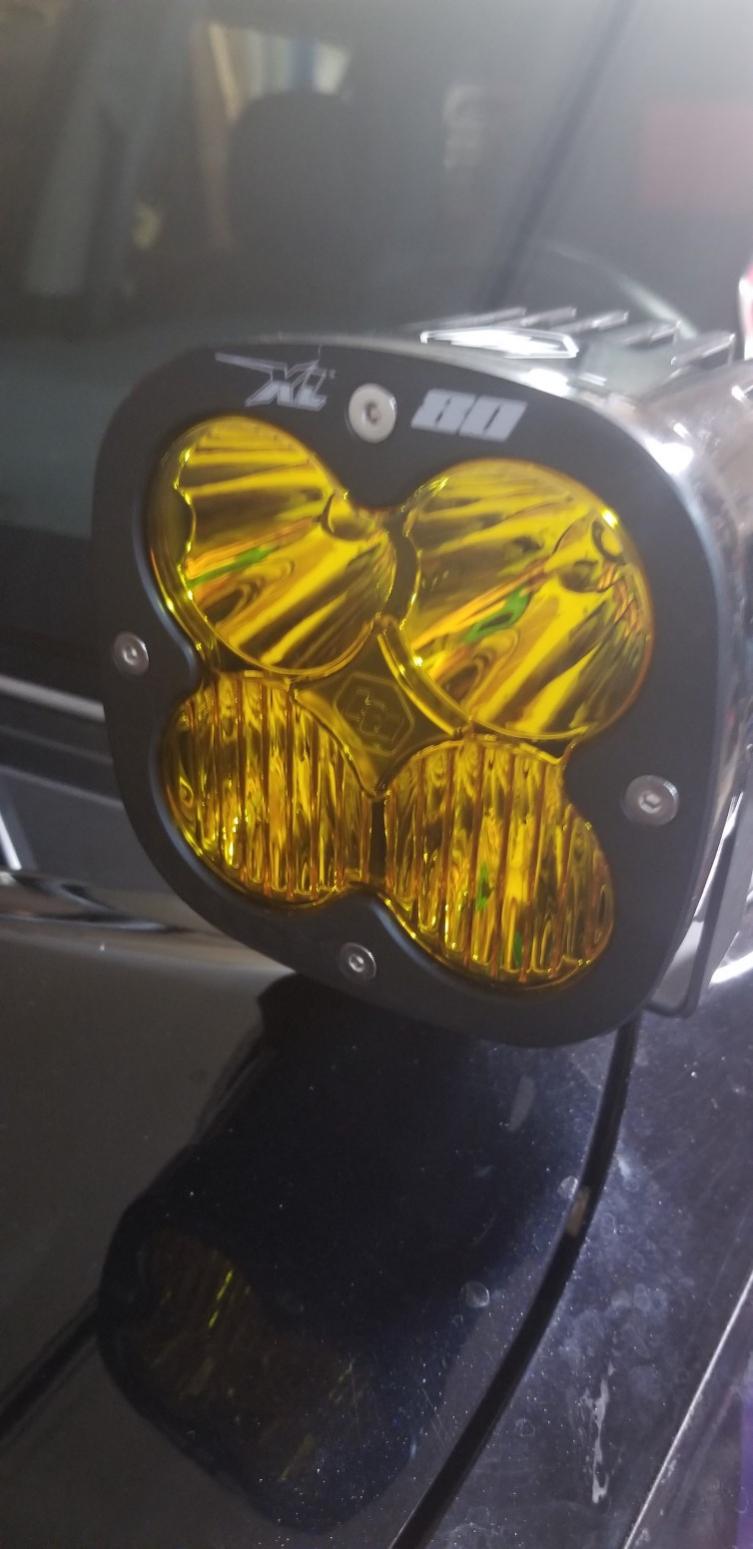

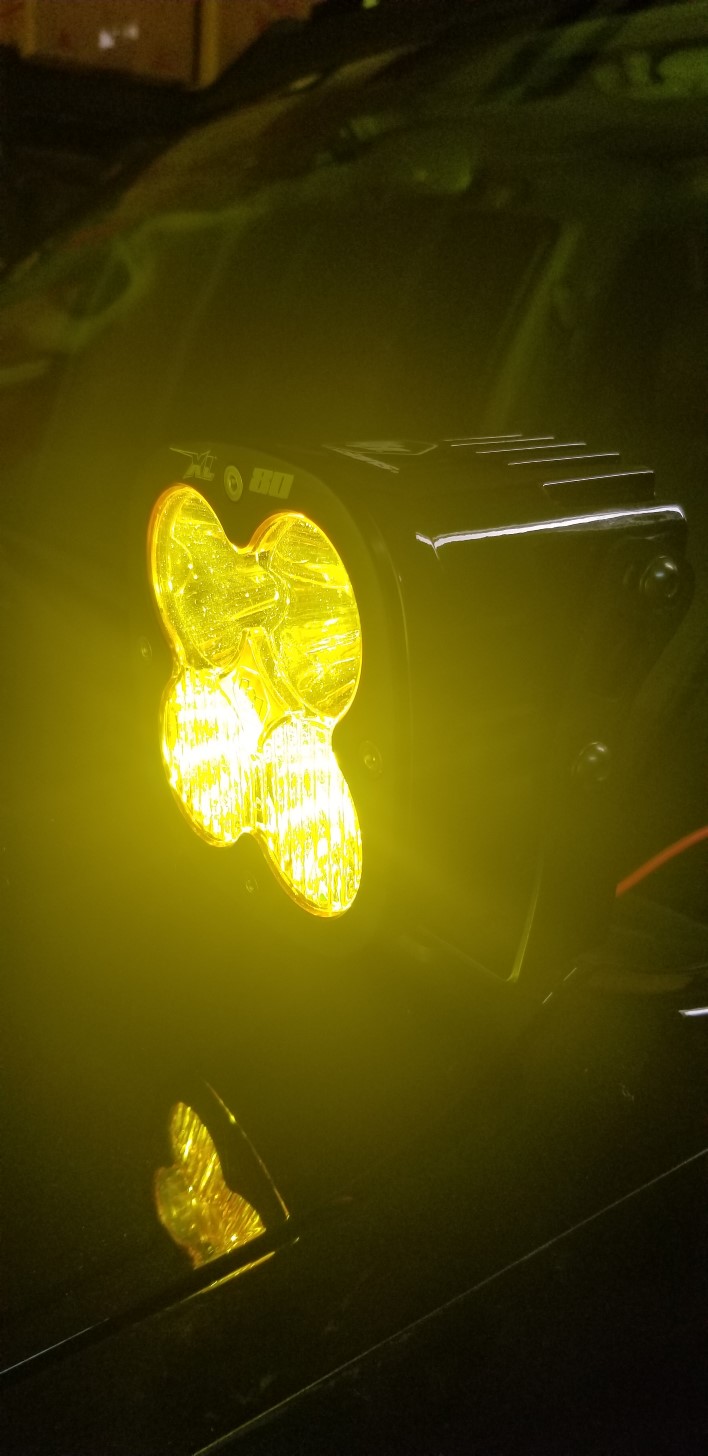

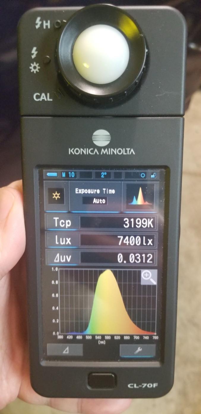

THe initial Lumen claim 15K+ with an actual claimed measurement of 8560Lumens seems...abit high.
What type of instrument did they measure the output with? Based on weak light pattern seems maybe 2K or less.
I have lights that put out 9K Lumens and they are not comparable. Mine are also amber as well.
Nice install and write up though, hope you enjoy them.
Point of interest
I decided to go measure my Baja XL80s in LUX. Using a high end meter 6 feet from a single XL80 I got 7400 LUX on the surface which was white and therefore had some bounceback. Still based on Baja claiming 9200 Lumens at source seems reasonable amount of LUX. I could not get a LUX reading directly at the light as the output is past the filter cutoff, I would expect its over 20K LUX at beam. Anyhow gives you an idea of output.
For your bar you would want to measure at impact point to better see how much light actually hits target vs. is scattered due to inefficient reflectors or housing in the LED case.
The XL80s are extremely bright. Do not look into the beam... like I did..all I can see is yellow squares. ugh :popcorn:
This isnt to throw mud on your lights.. just pointing out that manufacturers sometimes stretch their Lux and or LUMEN outputs various ways. LUX is key as its what you actually get on target. Millions of Lumens doesnt matter much if its scattered all over the place and lost in transmission.

Sorry for the extremely late reply, I didn't get an email notification from this and the thread got buried by new posts. But, thank you for the kind words on my original writeup!
To answer your question, I don't know what instrument they used to measure output, and I don't have any fancy (or even cheap) tools to measure the light output. To be fair, the photos do not accurately portray the output of the light bar but I can understand your skepticism. After using it for a year, I have developed a few thoughts that I will put together a summary follow up post for.
In regards to a comparison to your Baja XL80s, this bar probably doesn't compete, but it also costs a fraction of the XL80s. Every aftermarket light has its pros and cons. What you need and are willing to sacrifice is unique to everyone. My original post was hopefully helpful to someone who is researching light bars and wants a perspective on the Lasfit light bar.
