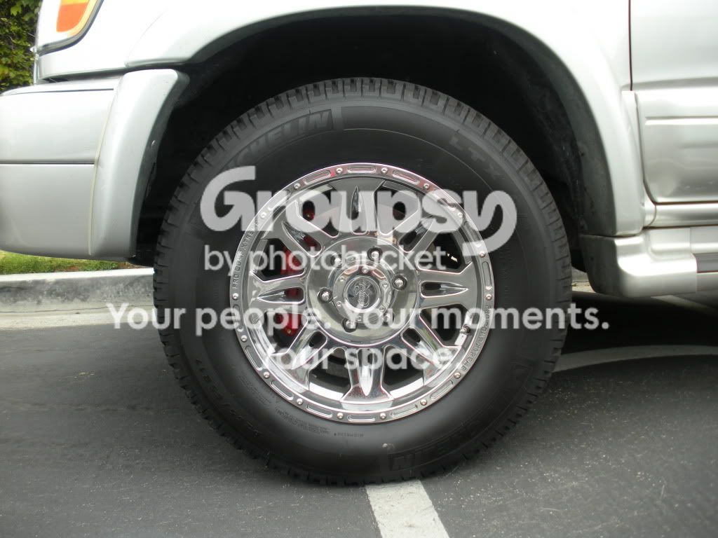

These are the wheels I had
DSCN2004.jpg~original
W/ the new wheels
DSCN0356.jpg~original

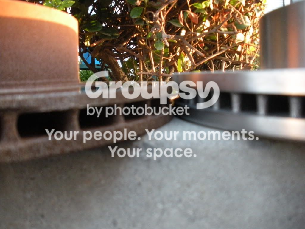

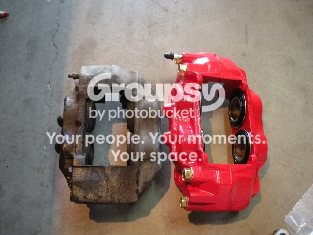

Comparison w/ the factory brakes vs. the Tundra 231mm's
DSCN0341.jpg~original
DSCN0344.jpg~original
