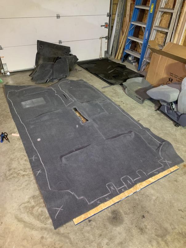

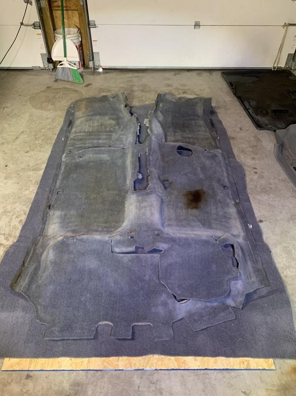

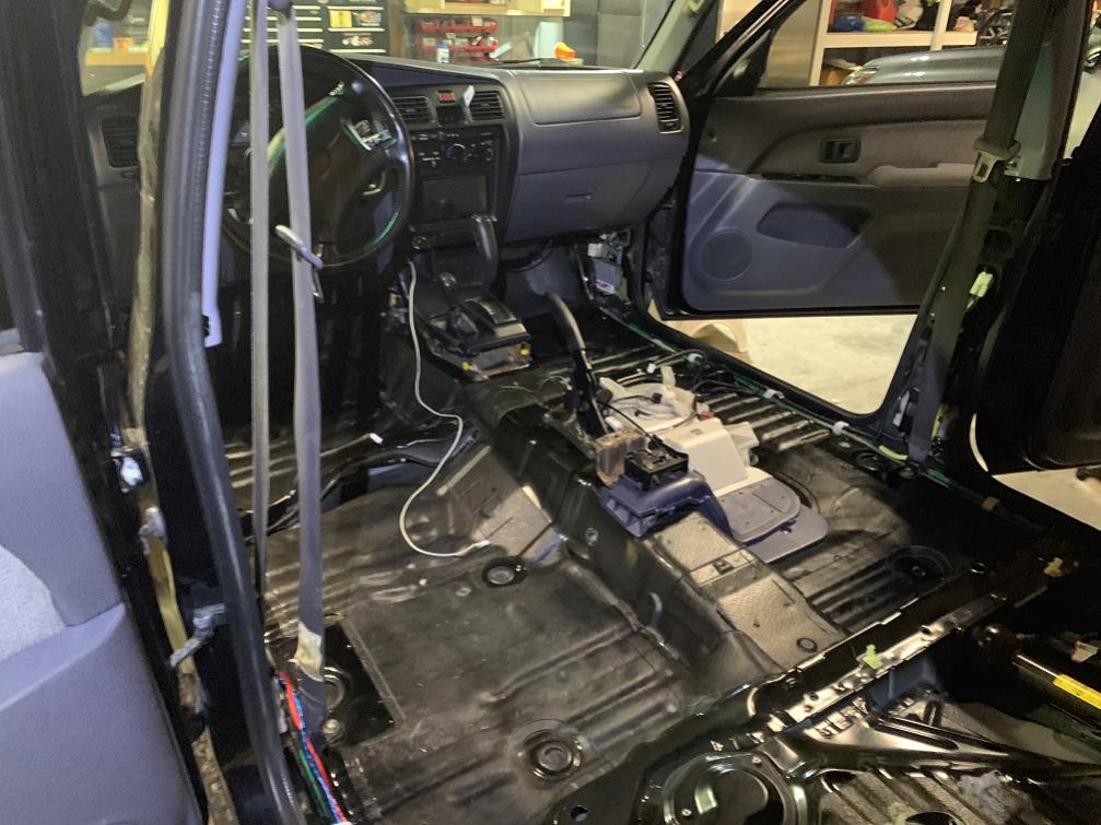

Attached a few pics from when i did mine. Did it over two afternoons but definitely could have gotten it done in a day. make your cuts very conservatively/slowly to avoid taking more material than absolutely necessary.
edit: should have also mentioned - they will send you free color samples if you need to make sure you're getting an exact match. i have the moon mist interior on a 99 and i ordered color# 8019 and it was a perfect fit. shipping was $50 so it ended up being ~$225. absolutely worth it. interior looks amazing now.
