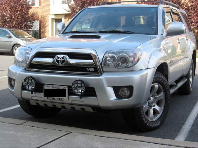

Well...got my truck back from the dealer...ended up being an Ignition fuse (thought I checked that)...minimal financial damage. Did all the fog light mods with no problems...thanks to all for your suggestions.
Added the PIAA 520 ATP lights - floating mounts
Added PIAA halogen bulbs for the high and fog lights.
Next step is HID lights for low beams.
Can't wait for a warmer day to shine this puppy up.
