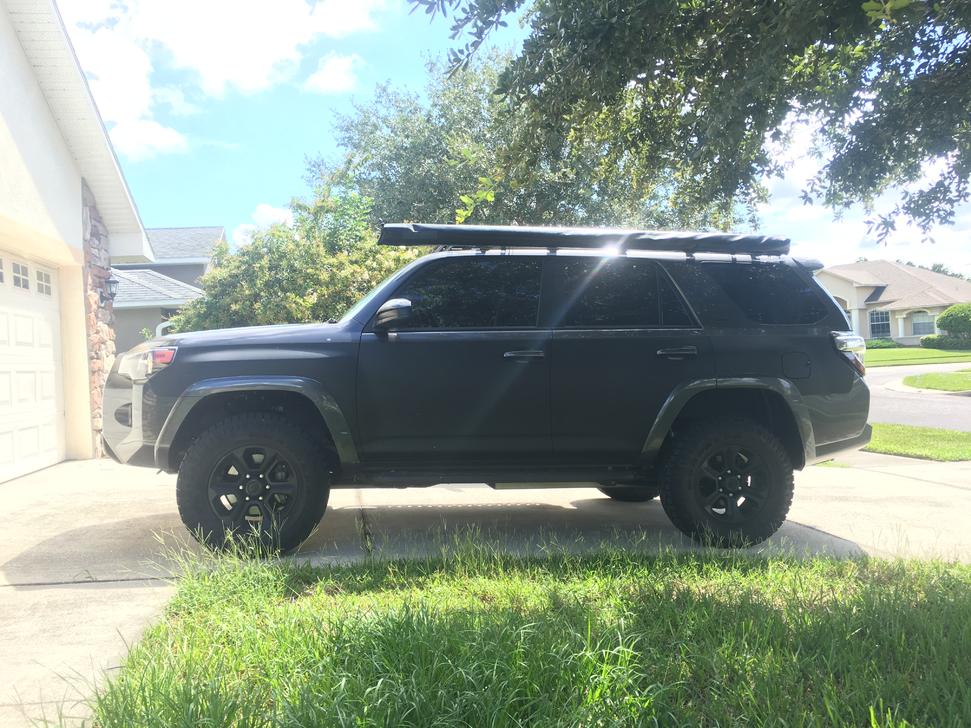

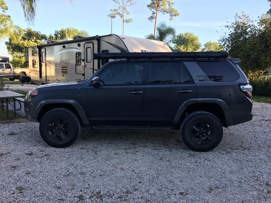

can you post a picture of your 4runner from the side? I was set to order these after seeing [MENTION=131488]ST1FLER[/MENTION] 's post BUT hearing the new ones give 2"+ I am a little leery
Most folks got around 2" even with the SAW coils, I was closer to 1.5" with third row, steel skids and sliders, and the stuff I carry in the back. I'm sure wheelers just used the same description since it's basically the same coil. Honestly I don't think most people would notice 1/4-1/2 difference in ride height, it's the reverse rake that tends to stand out.
Not sure I have a perfect from the side shot. Let me see what I've got.
I've got Billy5100's on the fronts set to the 3rd ring, so something like 1.75" lift on the front and I was fender level with stock springs, but if you put ANYTHING in the back you'd be nose high in the front instantly. I feel like I'm back to a factory rake at this point, definitely butt high but once loaded should be good to go.
Only shot i have since I did the springs. And the angle is terrible
ok. I have my fronts set to 2.25"

I have a LE w/ 3rd row, rock sliders, and an aluminum fuel tank skid. I have 6112/5160 with 2" on the front and 1.5" SAW on the rear and I would say I have a slight forward rake. With camping gear I am probably level. If you go 2.5" up front, I suggest going to 2" Icons or Toytec Superflex.
Bumping for pics.. Just got the T12s in and already have the 6112s up front on 2nd notch from below with ~1.25" lift.
SSO rear bumper might be a while out given their current situation.. kinda worried I'd have too much rake if these go on now. Anyone got pics close to my numbers?
[MENTION=122499]guitarsail[/MENTION] any chance you got better side shots with these??

Here ya go brother.
