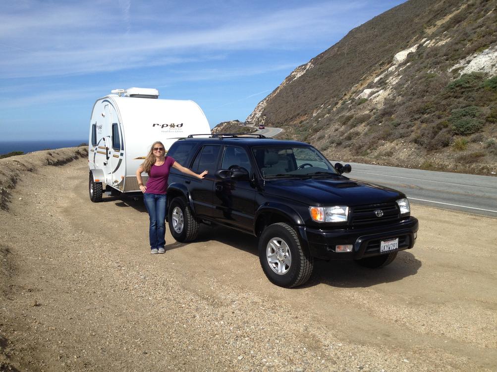

Interesting to read. I'm running an airbag set-up in our rig, with a T. I can't say as though I've experienced first hand that body roll issue, and we do drive on a very twisty highway (CA 17 between Los Gatos and Santa Cruz) at the start and end of every camping trip. Big sur is a regular destination for us too, as well as Fremont Peak (which is a super steep goat trial of a twisty road). The flow of air in the connector tube is pretty restricted by the small diameter of the tube. I'd imagine that flow between bags could indeed hapen, I just can't say as though it would happen fast enough to induce oscillation. That said - if there's some data out there to show that it indeed does occur, I'd update our system to separate valves and lines.
What I can definatively share is that use of a weight distribution hitch, and proper F/R loading of our trailer makes a very noticeable difference. We tow a 3500 pound rPod trailer fairly regularly with a 2000 SR5 manual rig. The WDH with a tongue heavy load makes huge improvments.
