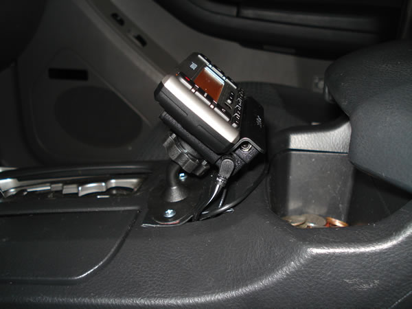

FYI, I installed my receiver where the unused buttons are between the shifter and middle console. It works perfect and I didn't need any mounting brackets and didn't have to drill any holes. All the extra cable and second 12v outlet (I installed a second one to plug the unit into) all fit down in there with space to spare.
I cut a piece if cardboard about two inches square and covered it with black electrical tape. This helps cushion the receiver mount to eliminate any possible vibration, and blends in with the color of the interior. I used a metal bracket that comes with home door latches on the underside to put the screws into (it was perfect match). It's all nice and snug and out of the way.
This works well for me. I usually rest my arm on the console, and this puts the receiver at my finger tips. It does not interfere with shifting at all.
