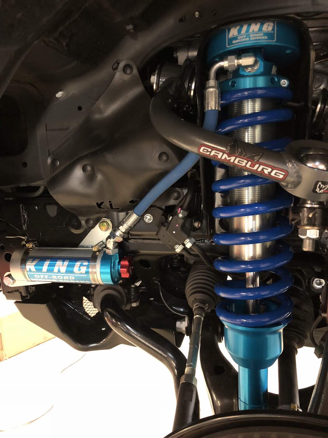

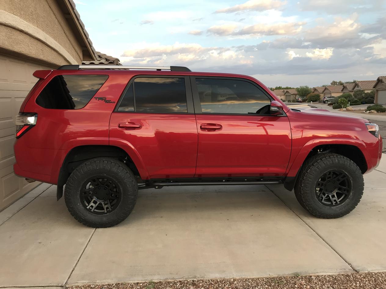

I am running ADS C/O's and rear shocks. They are simply amazing. I ran Icon on my Tacoma, and there is no comparison, the ADS rides soooo much better. They use the same quality components that they use in there high dollar race shock.
Wondering what people think about these options compared to the stock suspension as far as a supple ride. I've read so many conflicting thoughts on Kings/Icons/Fox/etc, I'm in a similar position as OP, looking for as soft a ride as possible.

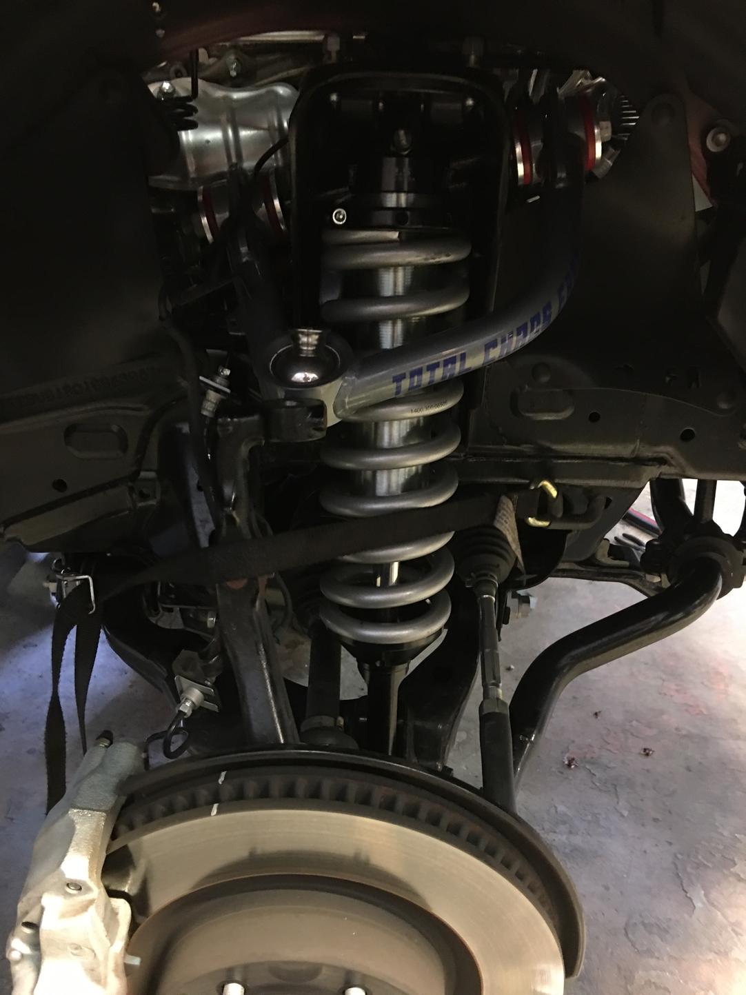

I'm super pleased w/ Toytec Boss kit and TC UCAs (link in sig). IMHO, best (or darned good at least) bang for the buck if you're not hard core wheeling. I went w/ the HD rears b/c of my 130# box of crap I haul around w/ me.
I've driven 2000+ highway and 100s of around town miles since having it installed. Finally got off road this weekend at Fort Fisher. Have been many times b/f new suspension and was a great pleasure driving w/ new setup. For one, no more dragging skid plates on the sand; and B, although still "soft" the front was much less bouncy than before.
my $0.02 :cool:
https://www.toyteclifts.com/ttboss-4r210-toytec-boss-suspension-system-for-10-4runner-and-gx460.html
coils: 650# front; heavy duty rear
