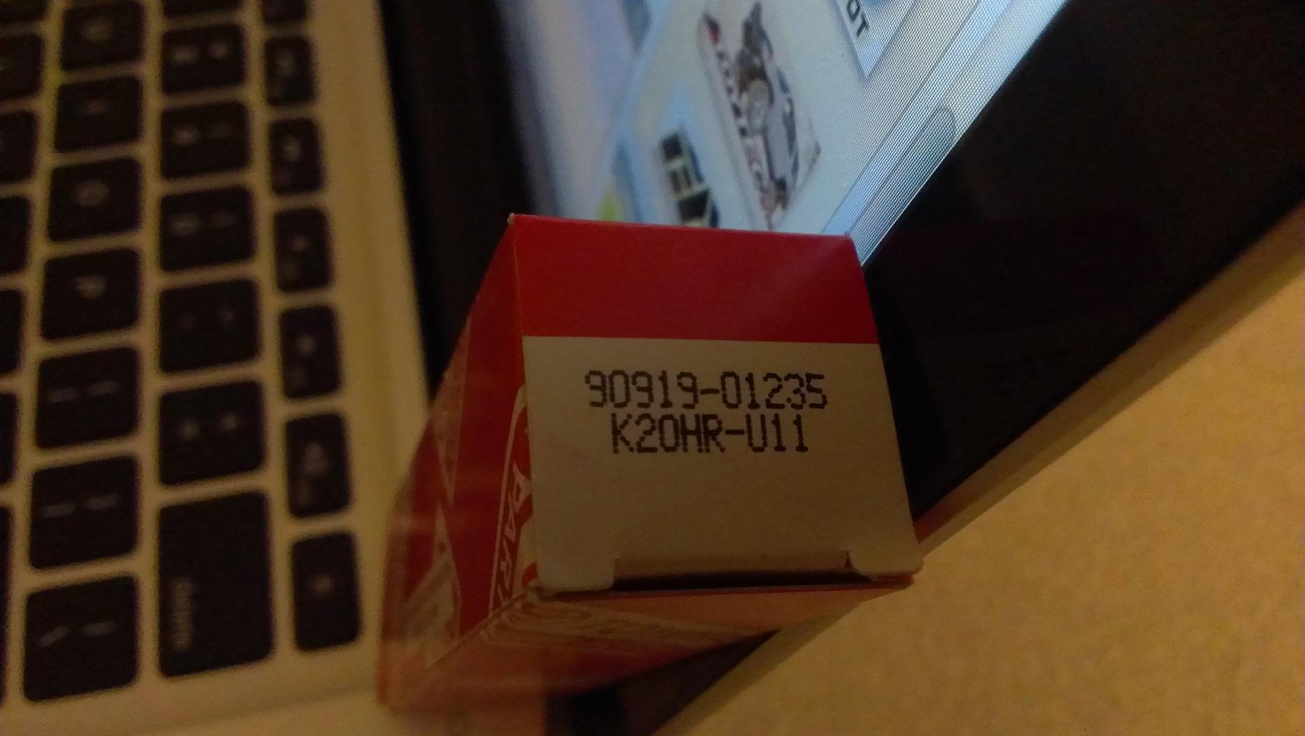

Do you happen to know which part number the dealer provides?
there ya go
