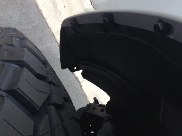

Need to trim just a 1/4" off my front bumper, got slight rub at full lock reverse. I was thinking a 3" x 1/16" cut off wheel on a pneumatic panel cutter that I already own but it might be to aggressive. Id like it to look as clean as possible. I dont own a dremel tool but that might be another option.
Dont have MS paint but Im talking about the edge where I pushed the wheel well forward.
