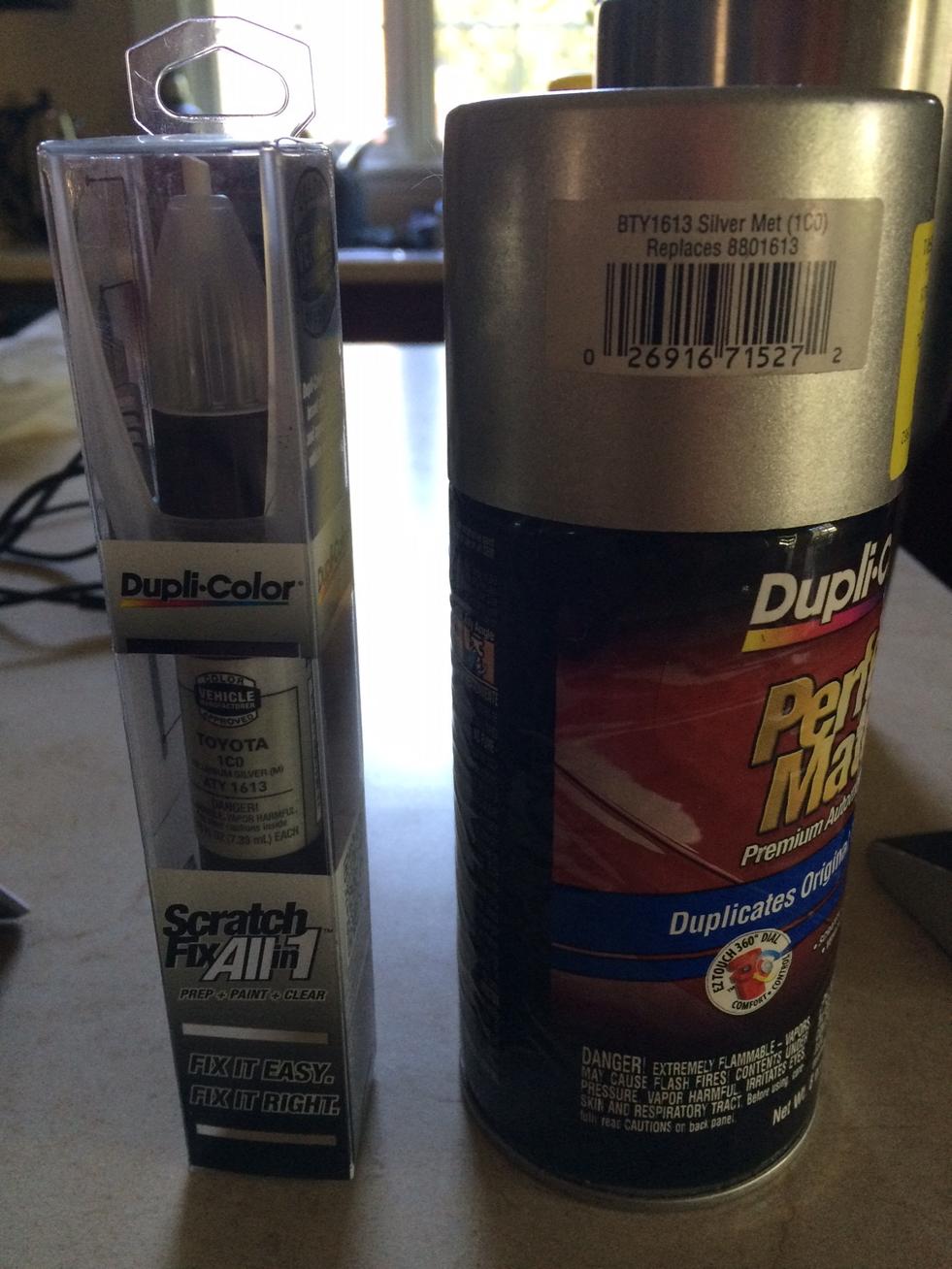

ATY1613 for the pen
BTY1613 for the can
This is what I use. Bought at any auto parts store
Good luck
