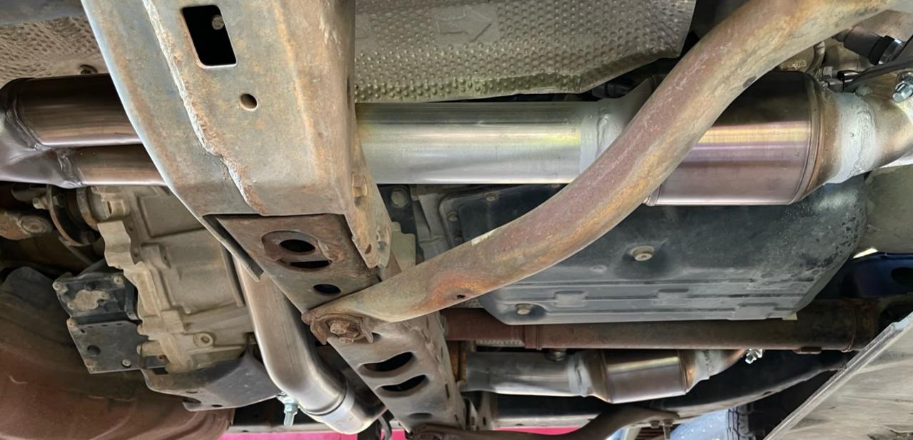

I'm going long tubes. I'm going to put GESi Cats in place of the Resonators to. That way, if there are any issues in the future with cats, they are much easier to get to then having to remove the manifolds/headers. The funny thing is they said the stock studs from Toyota are really good. My son put on the titanium studs.
