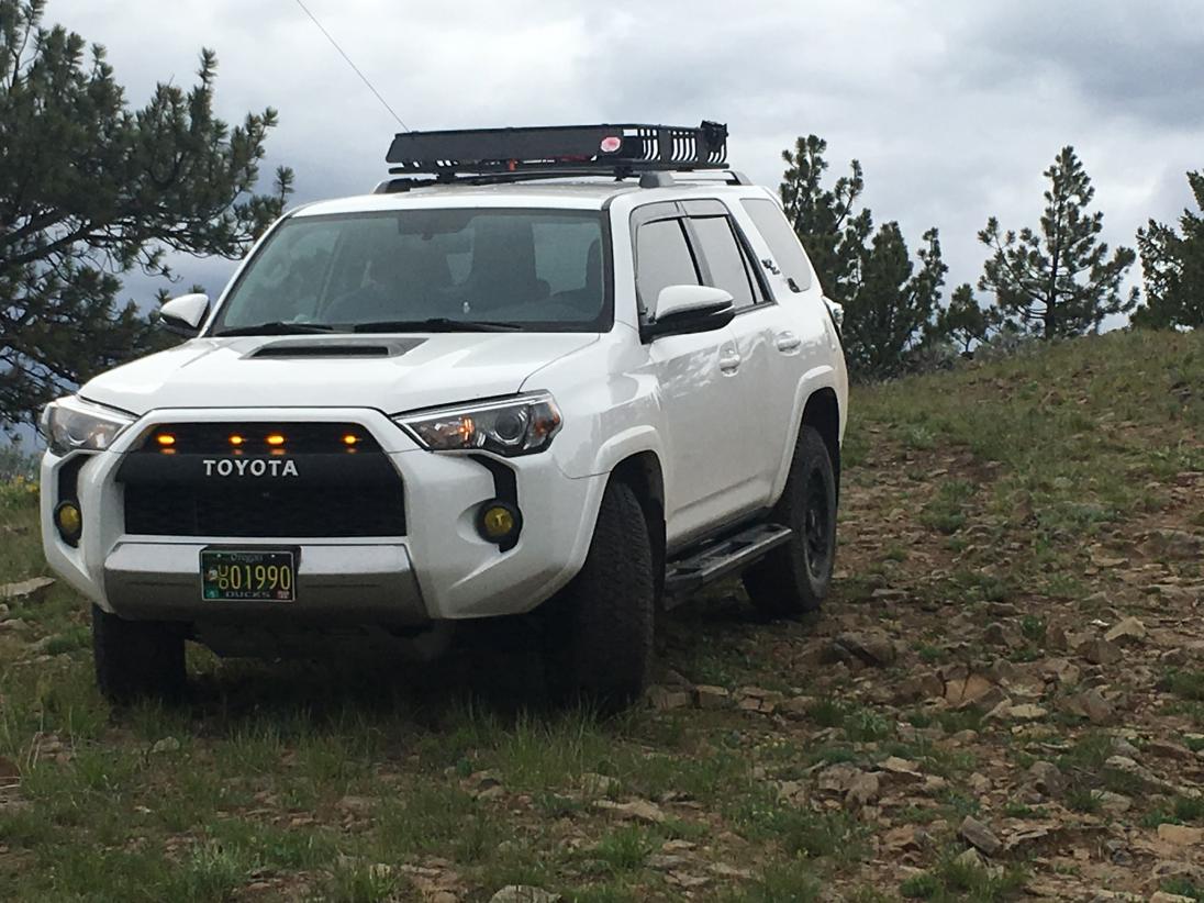

I’ve got the AVS low profile ones on my 4Runner. I’ve had the in-channel type from AVS on other vehicles, and these are the first I’ve had that just applied from the outside with 3M tape. They’ve been on there a year and so far no signs of impending failure at all, and I run all the time with all 5 windows open wide. They are pretty quiet and a have a sleeker look compared to most other options I looked at. They are also very reasonably priced compared to OEM or Weathertech. I like to be able to crack the windows while parked and not have to worry about afternoon thunderstorms getting the interior wet. I would definitely recommend them.

Ditto the above, 3 years on 16 SR5, survived brush and brushless car washes, power washing too. No wind noise, easy to install, they wont come off.
Too many posts about the in channel ones falling out.
