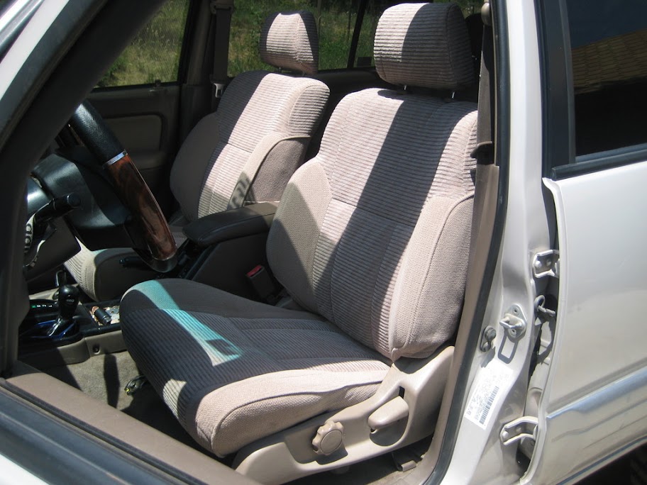

Pic of the style seats I have (not my truck, just found the image on the web):

I have logged many a 10-12 hour day in my runner with no problems, (6'3" 200lbs). Do you have the "sport" seats in the sr5 package or the standard, vinyl-backed spring slab seats? It's my understanding that the sport seats are just a cloth, non power version of the limited seats and overall I'm satisfied with position, adjustability, etc.
If you find a more upright seat I would think that your head would be in danger of hitting the liner, since mine does when I have the lower part of the seat raised all the way up. I'd be interested to see if anyone out there has a successful experience with aftermarket seats, though...

you aren't driving the right toyotas, the 2nd and 3rd gen supras had recaro seats in them factory, and are really the most comfortable seats i have ever sat in.
as for the original poster, it depends on how much money you want to spend, there are aftermarket seats out there, that you can try out, or hit up a junk yard and start looking for some low millage seats and find someone to fab up some brackets.
i have the cloth sport seats in my 4runner. my driver side seat padding is worn down but my passenger seat is still thick and comfortable. i let my girl drive my 4runner every so often and when i sit on the passenger seat, its really comfortable. I'm 6' 220 pounds and driving and sitting in traffic sometimes i start to feel uncomfortable. i think the issue is padding and not so much the seat. maybe if you got the seat reupholstered with new foam that might help out. but that's just my two cents.

I wound up swapping my original seats for some seats from a Sport model. This has helped quite a bit. I won't say they are perfect by any means, but it is a great improvement.
There are some other options that you can do with your existing seats as mentioned in my thread.

I have back issues and thus a strong interest in good seats. In my 1988 1st gen, the difference between the stock buckets and the optional "Sport" seats was huge- the sport seats were very nice, with adjustable bottom cushion height/tilt, adjustable side bolsters, adjustable lumbar support, and adjustable headrest tilt.
I also tried some 2nd gen "Sport" seats in my 1st gen runner- the fabric was in better shape and they had rear map/road atlas pockets. But they didn't seem quite as comfortable, mainly I think because the bottom cushion didn't tilt up as much, so I had the 1st gen sport seats re-upholstered and used them until I sold that vehicle.
My 2000 3rd gen came with the base seats, which I've since swapped with 3rd gen "Sport" seats. The new seats are considerably better, but the difference is not as great as with the 1st gens- the bottom cushion adjustment drops the rear part of the cushion instead of raising the front, which doesn't result in as good of a fit for me. Also, the 3rd gens don't have the side bolster adjustment, and overall seem to have less plush padding. But they are still a definite improvement, and would be the easiest route to go since they are a straight bolt-in.
The Volvo seat idea is intriguing, but any seat from a different manufacturer could involve issues with fit if the seat is wider than 4runner seats, and will definitely involve issues with bolting them to the floor.
