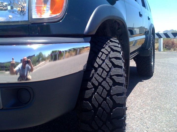

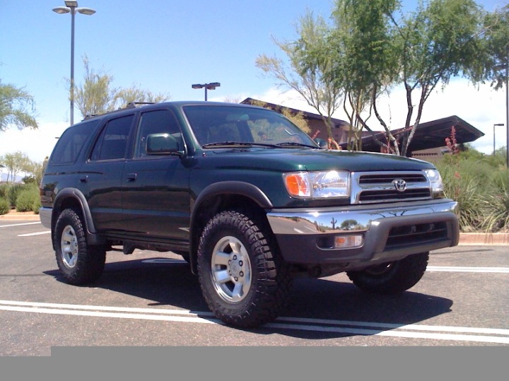

I used to be a huge BFG fan until my last set of 35's. It took me another tire store to figure it out but all 4 tires were out of round. Finally got them to take them back and that is when I went with the Tera Grappler's. However I just got the new Wrangler Duratrac's and love them so far.
I'm still considering the Duratracs or another set of the Nittos but I like the Duratracs more agressive looks and if they are in breathing distance of the Nitto's out the door price I might switch.
How is road noise with the Duratracs so far?

Hey Ron, as far as road noise they are pretty quite. They do put out a slight hum at higher speeds but nothing you can hear over the A/C. Really happy so far and I think you would be as well.
