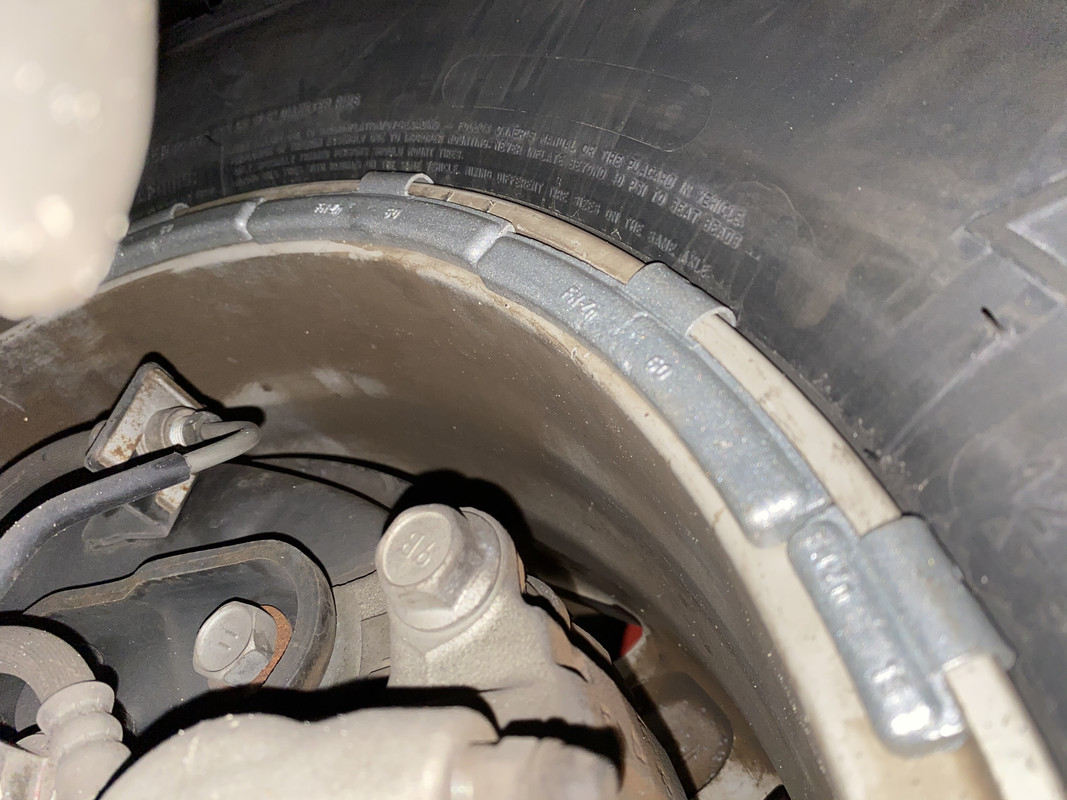

I had BFG KO2 size 275-70-17 mounted on stock 2015 Trail wheels today. The tech told me they had a hard time balancing one of the tires and it took 6 oz and was still not 100% balanced.
Is 6 oz an excessive amount of weight to balance these tires? They said if they have had another one in stock the would have switched it out and are willing to order me another tire.
Any thoughts?
I would have them get a new tire. There must be something wrong with the tire if you can't get it balanced. BFG is a good company and would stand by their tires, but rather than you having to hassle with BFG, let the tire store do it.
It’s Costco, and right now this size is out of stock.
Does that seem like a lot of weight?

Costco was great about this, they tried to order another tire but they were out of stock. Last night they became available again so I ordered 2 more just in case one of the two were also bad.
