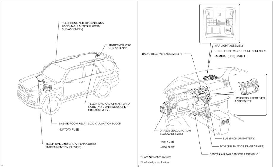

So I wanted to test what would happen if I pulled the DCM fuse:
395344d1650996611-how-disable-vehicle-tracking-data-2021-2022-models-5a5ff983-c7c5-4ae3-add6-27fb6b736914-jpeg
The first thing I noticed is that the DCM cellular signal indicator now read no bars. I had read elsewhere that some folks who had pulled the fuse lost one of the speakers, and the hands-free microphone in the upper console. In the case of my ‘22 ORP, all the speakers worked fine, but the microphone did not work. I know for lots of people this is not an essential feature, and for them perhaps pulling the fuse is the best way to go. But for me the microphone is a must-have. So I replaced the fuse and determined to investigate further. By the way, with the fuse pulled, all the key-fob functions worked perfectly, and the weather data was available, and the traffic showed up on the navigation screen. So I guess those bits of data come in over the HD radio rather than through the DCM.

It was interesting to note that with the services discontinued, the signal bars for the DCM still register a signal, while when the fuse is pulled there are no bars.
I am encouraged by the results of these tests, but two big questions remain. Has my truck truly stopped transmitting data? And if it has, does Toyota really have to have physical possession of my truck to turn data transfer back on? I don’t know.
I plan to open up the dash in a few weeks to install a GMRS radio. While the dash is open I’ll disconnect the antennas to the DCM. That will add an extra level of security.
