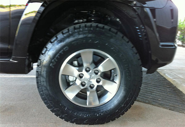

I'm trying to get some bigger tires on my stock 2011 T.E.. I really like the nitto terra grapplers but I was Just wondering what is the biggest size I can get without rubbing or anything of that sort??

I'm running 285/70/17 on my stock rims. Yes his are wider.
His are 285/50/20.
I think that they are 1/2 inch smaller then stock.

Ok, let me get this straight- We can put 275 70 17 tires on a stock, non-lifted TE with no rubbing issues? Does this include BFG AT KO's?
What about the same tires on a stock TE with ATX Mojave wheels? I don't plan on lifting my TE, but I would like the biggest tires possible and these wheels if there are no issues...

Today, I installed LT285-70-17 10 ply Nitto Terra Grapplers. Ride and looks better. I only have 1" daystar front spacer, rear airbags, minor mod to plastic in front wheel wells. I had the 265-70-17 Nittos. They are 4 ply and do not like the way they handle in the wind or pulling a boat.

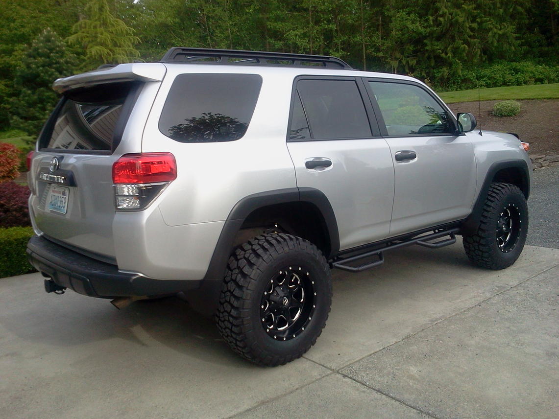

I love your truck, what lift did you put on it? If I missed it, sorry. I will go back and re-read the thread to be sure I didnt have on my blond wig!:naughty:
Thank you. I installed a 3 inch toytec lift. I'm very happy with it.

Lift it 3", you wont regret it. Then 285 70 17's
