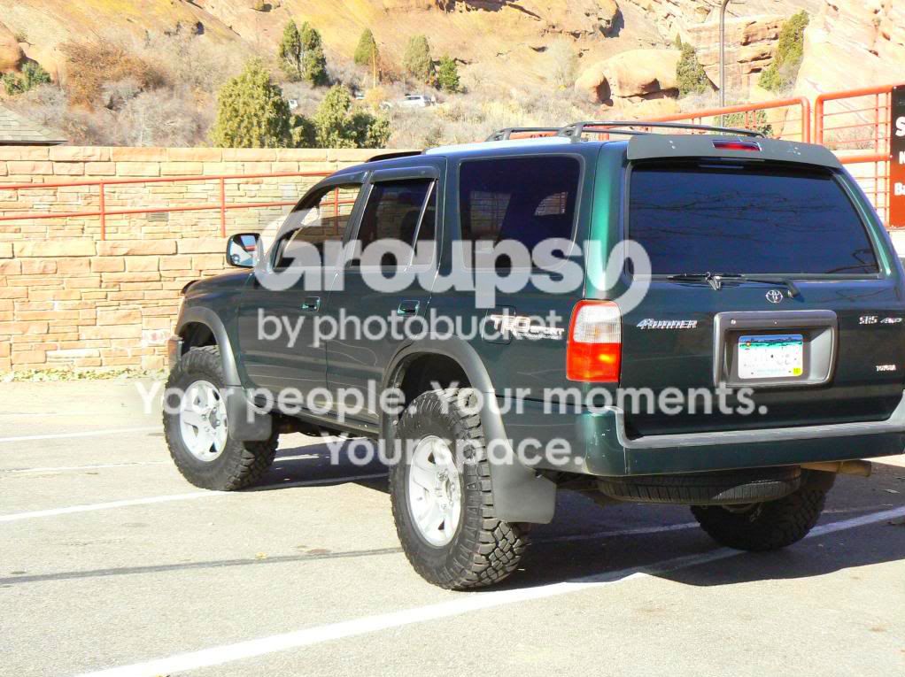

265/75 is the biggest with the stock suspension including the '99s and mine does have the taller coils.
P1050327.jpg~original
Clemson, did you have your speedo recalibrated? Do you have any rubbing at all? That is pretty much the exact setup I am wanting to put on my '01.
No, I didn't have it recalibrated. I think the dealership can do it, but I don't really want to pay that much to have it done. I think I also remember someone saying that going up in size actually makes the speedometer more accurate. Apparently it is a little off stock.
I don't have any rubbing, but it is pretty close. My '98 sits a little higher than your '01, so you might have a little, but I'm not positive.
No rubbing with 265/75/16 on my 01 SR5. I have duratracs if that matters. A 265/75/17 should also not rub as all the outer dimensions of the tire are the same as 265/75/16.
