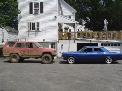

I disagree. I have 34's on stock suspention and the pictures to prove it. It only rubbed at lock, so i pulled the wheels off, and as earlier stated, knocked a weld down, and it worked fine. The weld is a pinch weld on the firewall, and it is very easy to take down.
