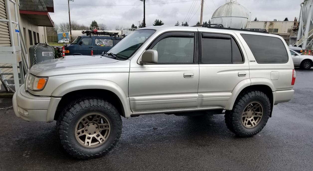

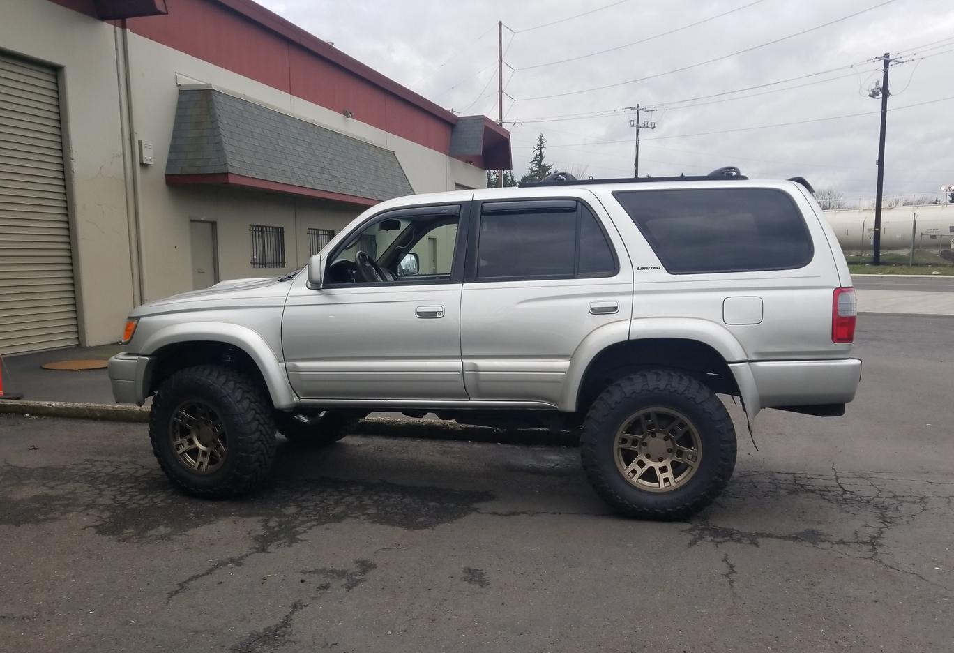

I did the toytec/eibach 4runner springs with the tundra bilstein 5100's and just went with LC 8 wraps in the rear. Here is a before and after picture. It had Revtek spacers on it before and I am extremely happy with how it looks now

Dannng, your truck looks great!

I'm looking at the same kit at the moment, great looking truck. What size tires are you running?

Been running the same kit for about 2 and have wheeled it pretty hard with no issues. Its a great daily driver and weekend wheeler kit IMO. Running 285/70 17s btw
