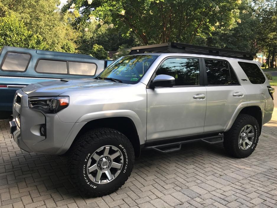

I have the exact same setup as you but with Falken Wildpeaks. It’s a great look for the truck. Minor rubbing when in full lock on reverse but not a big deal at all. Do it! Here’s an image of the truck (on the left) next to a nearly identical 4Runner on the right.

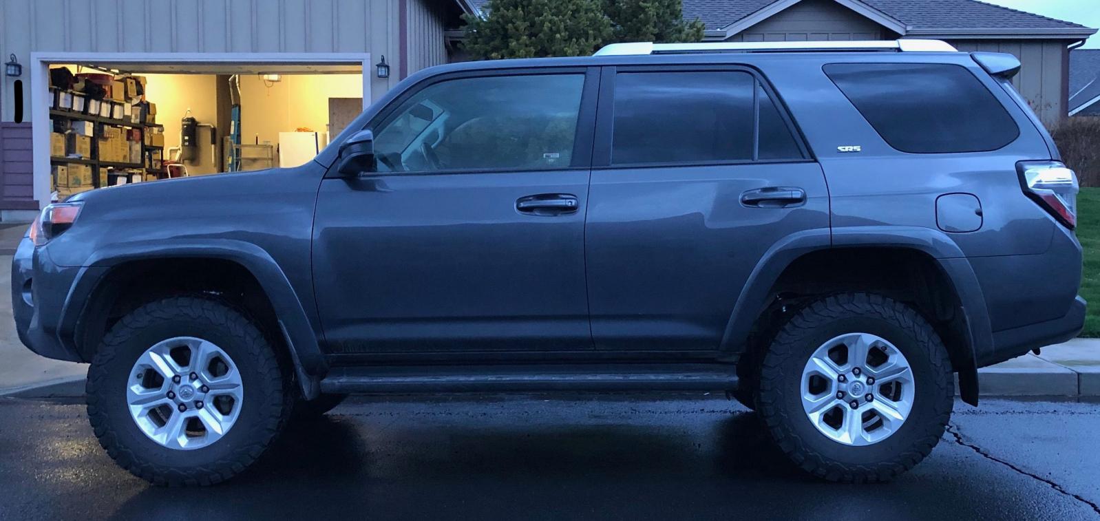

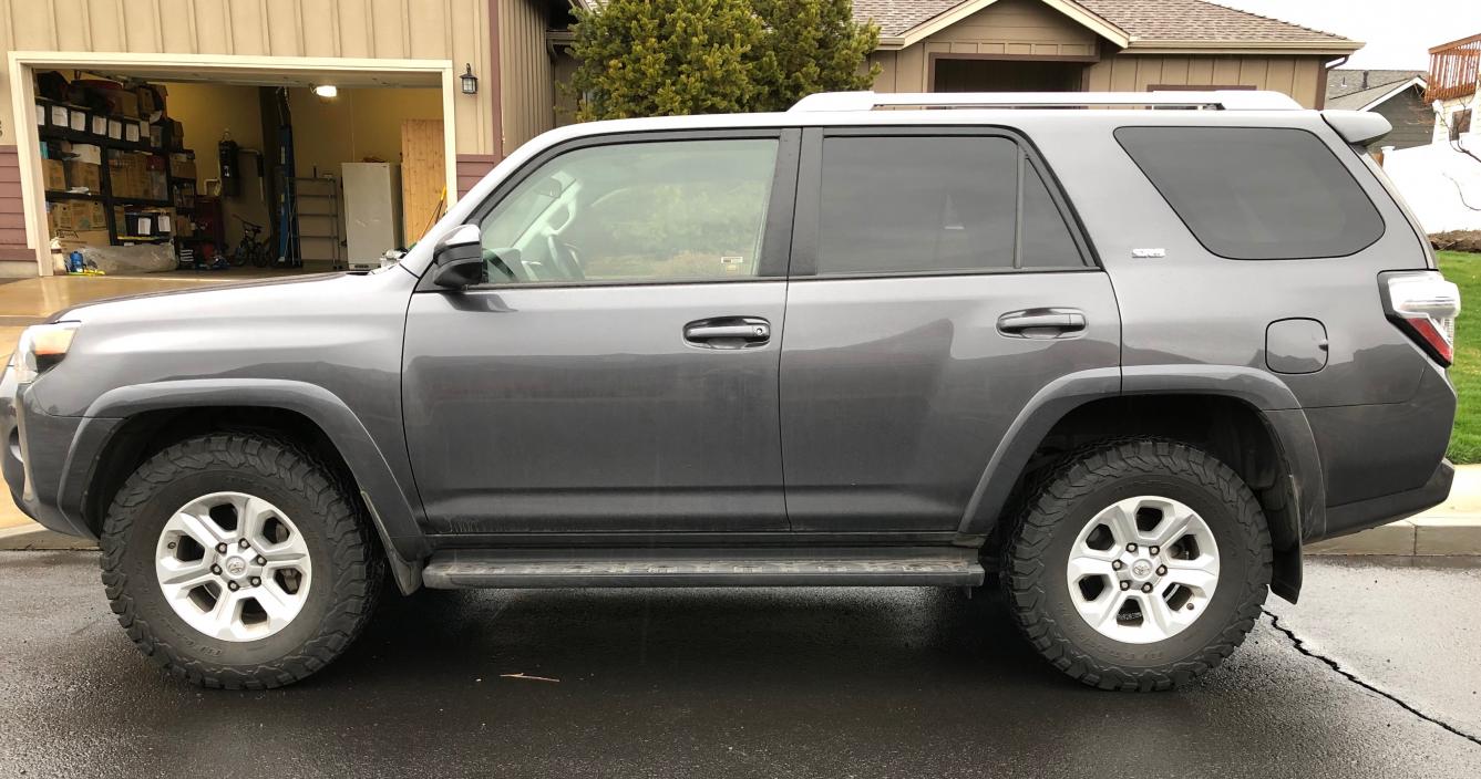

Got it all done over the weekend. Took me about 10 hours by myself. Posted my Before and After photos. The nose dive and body roll is completely gone. Rides like a dream!
2.5" Bilstein 5100 Front
1.5" Cornfed Rear Spacer w/ Bilstein 5100 Rear
JBA UCA STD
BFG KO2 275/70/17
Alignment After Install
Caster is at 3.9
Toe/Camber ~ 0.0
