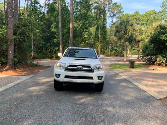

So finally at 230k I had a shop rip out the XREAS and install Bilstein 5100s on the stock springs.

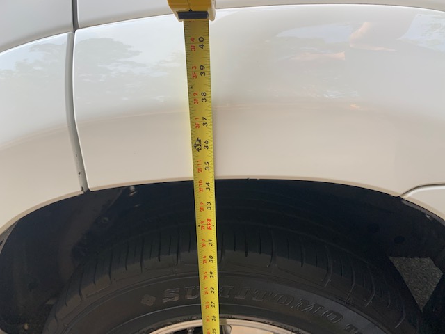

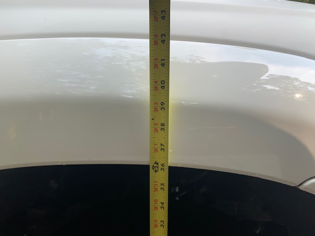

The difference is incredible and I’m kicking myself for waiting for so long. However it has a very noticeable lean and is nose high. The front passenger side is 36” and the drivers is only 34 3/4”. Very close # for rear as well
Is this normal? Will it settle? 2wd with half full gas tank

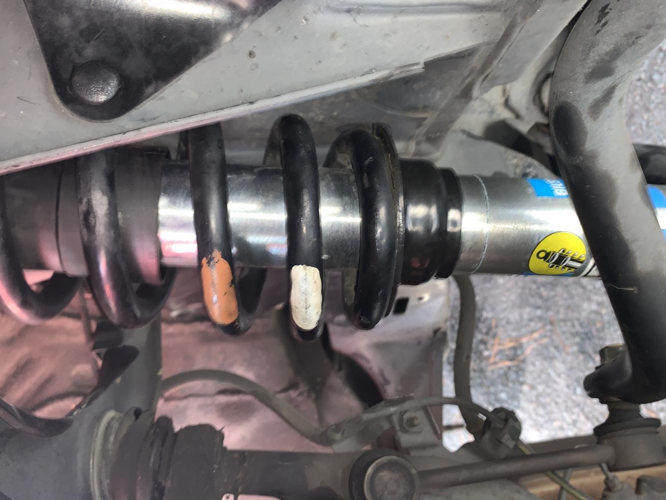

Upon further inspection it appears the passenger side spring perch is upside down…
