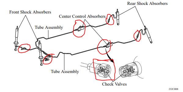

Dang, my old thread really needs to be made a sticky, because this gets asked so often.
Don't cut the lines. Removal is seriously simple. There are 6 check valves that you simply loosen and they separate with maybe a drip, then pull the components off. It is super easy and doesn't make a mess.
This video is the best out there so far and shows how to do it without a mess: X-REAS Suspension Delete From 4th Gen Toyota 4Runner - YouTube
Here are the 6 check valves' locations:
With regard to your 5100 compatibility question, your front "strut" is shock/spring/tophat, you can just replace the shock with the 5100 and I would suggest using the "no spring compressor" method. In the rear you are replacing shock for shock. When I did mine on a 4th gen I replaced the springs too, with new FJ springs, but that's up to you.
