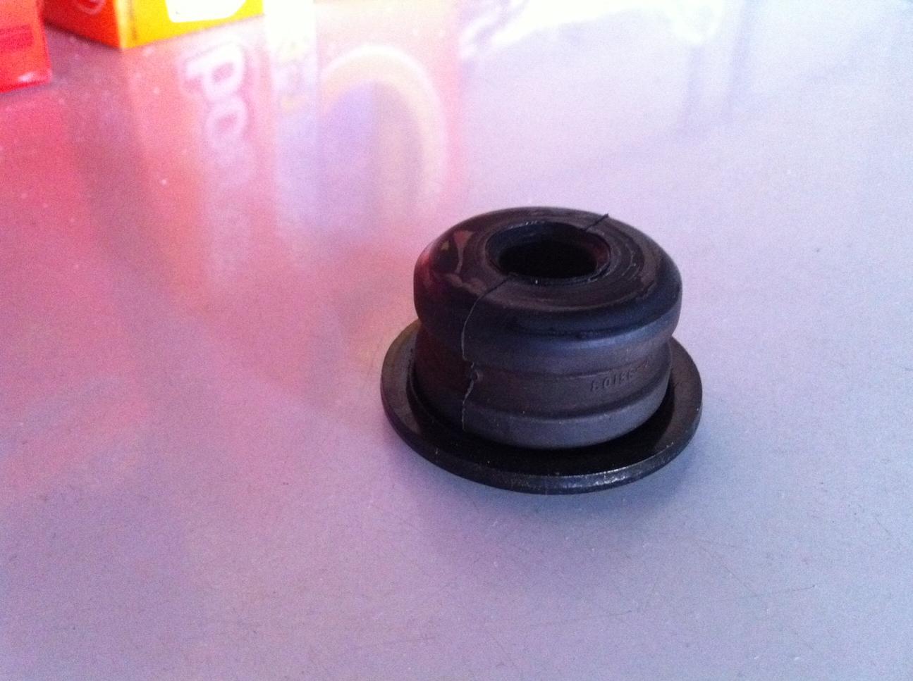

now the question i have is since i wasn't able to stay for the install.. in the box with stock shocks that they returned to me there's a rubber grommet type of thing which apparently is not needed.. i just want to make sure that this is normal to not need this part..
i had it installed at offroad warehouse and they obviously know what they're doing
any one with bilsteins can confirm?

I think that might be the bushing from the bottom of your old shock. Check them to see if one is missing. I'm sure they would've installed the new ones with the Billy ones that are already on the shock. Could be wrong because I've never looked at the OEM bushings.

That is the stock bushing that goes on the top between the frame and the nut on your old rear shocks.Each side in the rear should have one.It's upside down from the way it goes in the pic. Your new Billies had their own as they are not all alike.
Usually a shop will put them back on the old shock with the nut to hold it in place for the next person that installs it on their truck.
