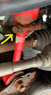

I'm in the market for this set now but I'd like to ping those more knowledgeable than I first. I have a '15 4Runner Limited and my struts/shock front and rear have these hydraulic lines hooked up to them that I do not see in the pictures shown for the Bilsteins. Is the 5100 Complete Kits advertised here the correct kit for my 4R? Here is a picture of my rear right side shock

If that's the XREAS system then there's no substitute that I know of.
I did more research on this forum and sure enough, it's XREAS and man is it expensive to replace! You have to replace all four at once as well as the lines and pump. Total cost is about $4,000. I'm looking into an XREAS delete option now. I'd like to get new shocks and coils all around. I'm not a big off-roader so a lift per se isn't something I'm after.
