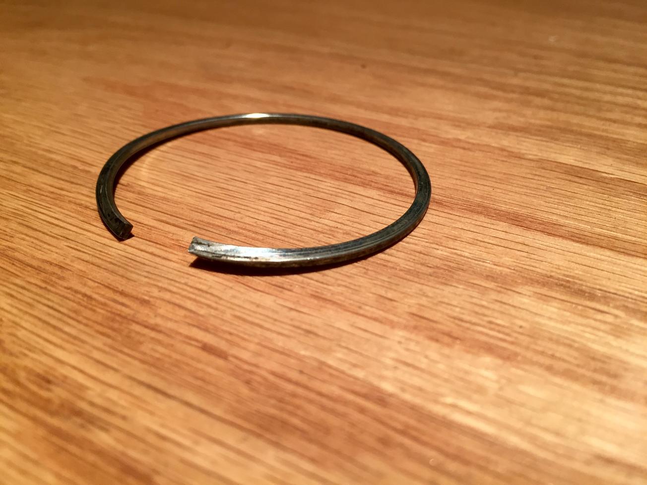

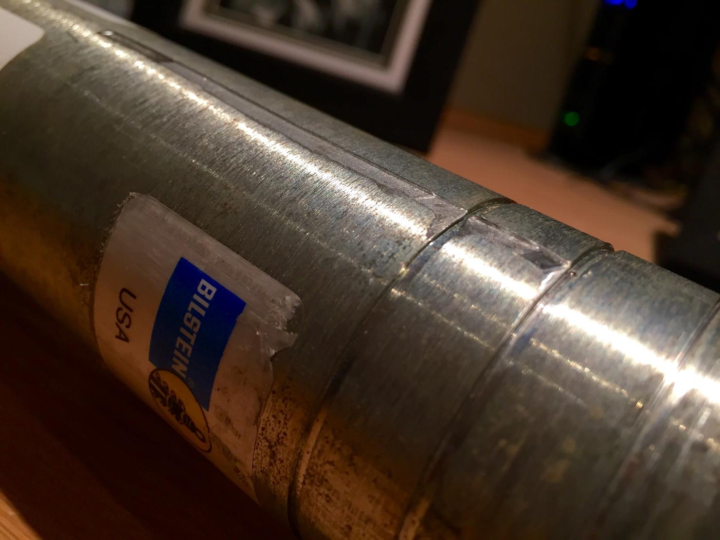

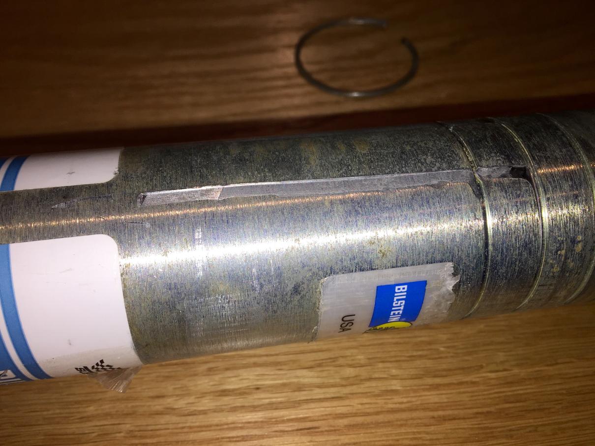

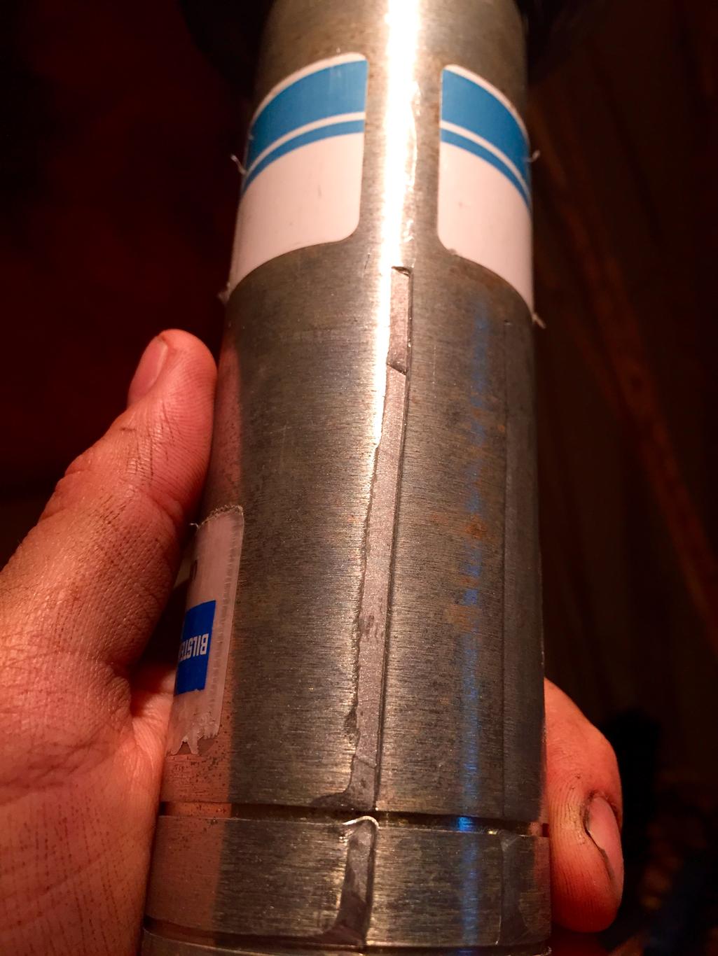

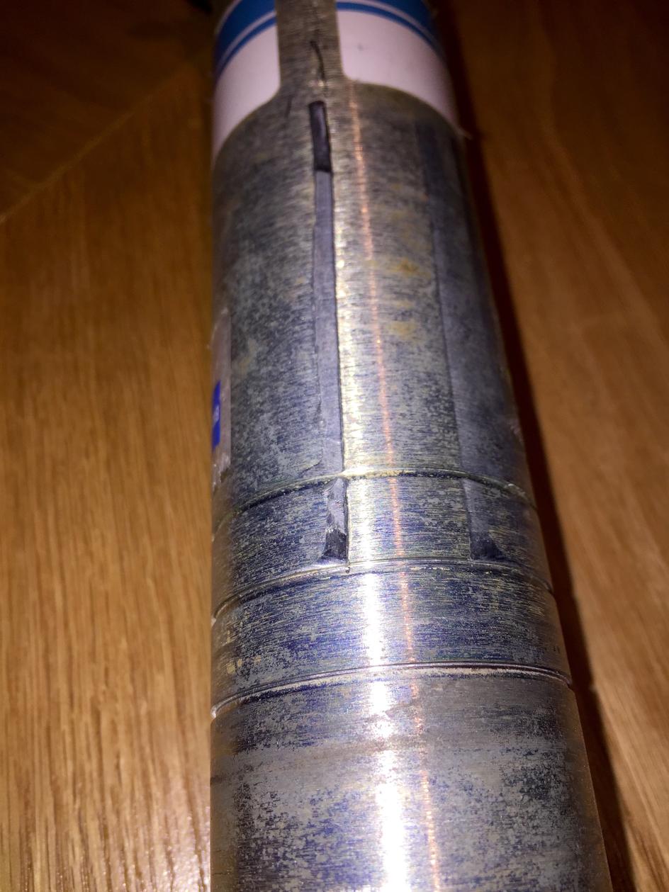

Hello,
I decided to order some Eibach Coils to mate with my Bilstein 5100's. Up until this point, I was running the 5100's on the 3rd Ring (Height) for 2.5 inches of lift and the stock coils. Yesterday, I removed the old coils and installed the Eibach coils on the 2nd height adjustment.
I read on Wheelers offroad that the 5100's and Eibach coils work well on the second height setting, so that is what I did, to obtain 3 inches of lift. After lowering the vehicle back to the ground, five minutes went by and we heard a loud "pop" and the front end of the vehicle dropped.
After examining the noise, we could see that the snap ring failed and the suspension dropped completely on the driver side. I'm not sure if the recessed setting on the shock could have been faulty, or the snap ring itself was bad (possibly a combination of both).
We never took the snap ring off the shock and we ensured it was seated properly in the 2nd perch setting. Has anyone else experience this in the past? I was basically looking for no more than 3 inches of lift up front.
Thanks

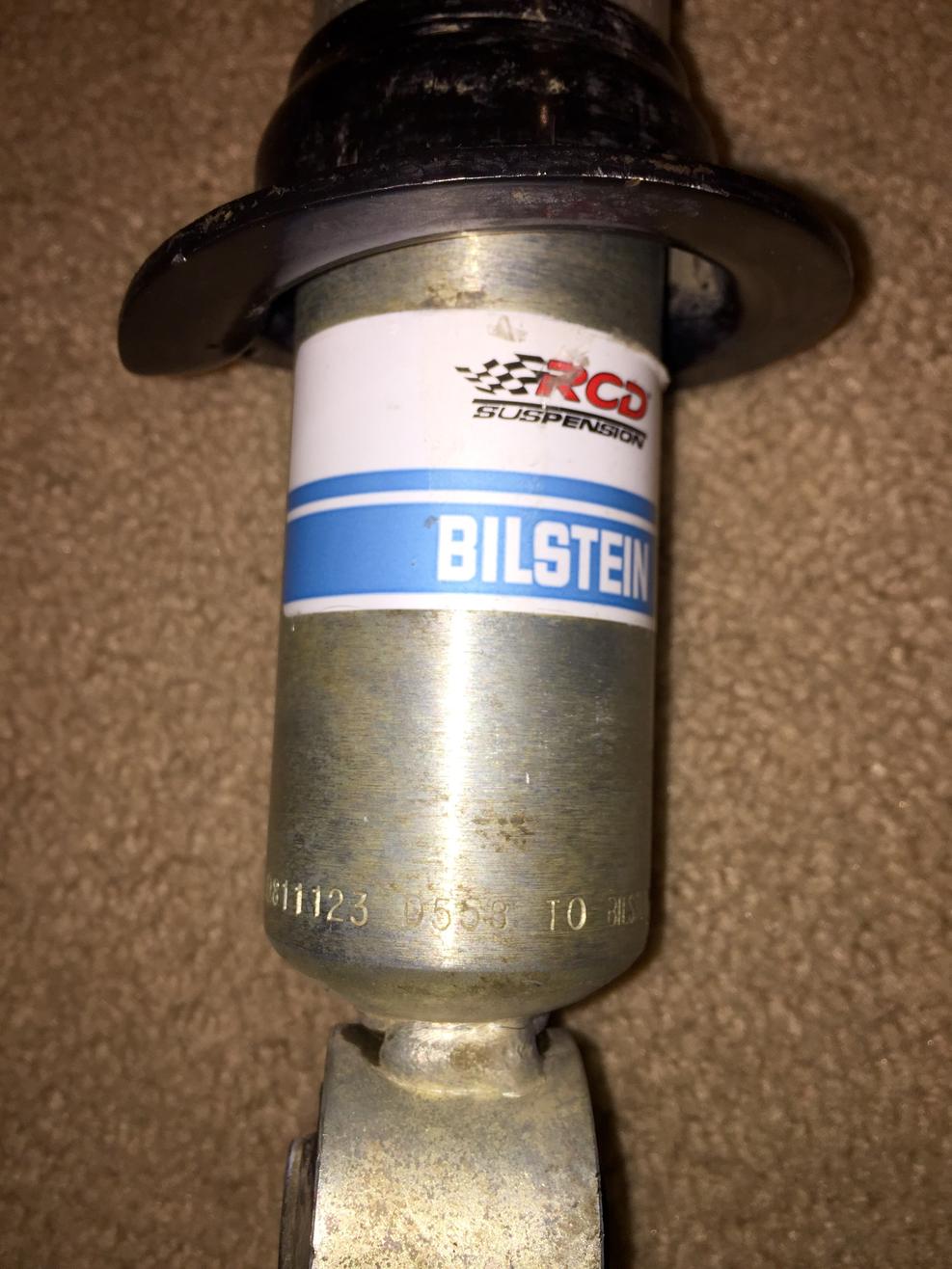

You are using a D558 5100 which is made for Taco/4runner. Many of us actually use the 5100 for Tundras. The difference is that the D558 only has 3 spring perches while the Tundra has 5.
I suspect what you read was that it was okay to run the Tundra 5100 on the second perch with Eibach coils. The second perch on the D558 is supposedly equal to the 3rd perch on the Tundra 5100.
This all probably means the coil was a little too much overcompressed on the second setting, but I don't think that's necessarily means for the whole snap ring to fail. Maybe there was a little bit of dirt in there and it didn't seat properly?
No matter what the reason that snap ring failed, I would run that Eibach coil on the lowest setting per most peoples recommendation.

Huh, that crazy. Sounds like you did everything right. I wonder if the ring was slightly twisted (like it is in the picture, but to a lesser degree) and if that caused it to slide down, starting at the gap.

considering you just moved the ring, I suspect the ring swept some grime into the slot which allowed it to roll over like you can see in the picture. even if this had happened while driving, the worst case is you would be sitting on the bump stop, it would definitely throw you off though and cause an accident.
moral is, clean out the grooves if you plan to move the snap ring, I clean my shocks off thoroughly every time i have moved the rings.
