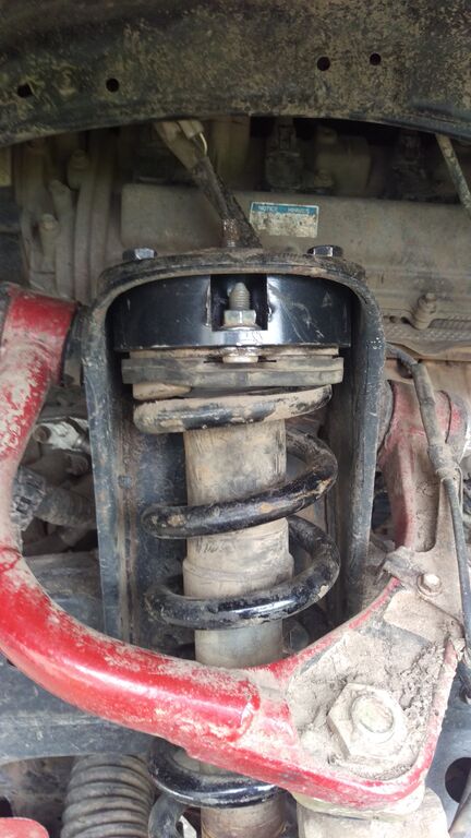

I switched mine from 2.5" setting on stock coils to 0" setting and 3" lift spacer. Much softer ride around town, which is what you are looking for, but it doesn't seem to be as good at soaking up bumps offroad, which you aren't worried about. Someday I'll be able to afford some better quality coilovers and be all set.
t-man: I also had my 5100s set at 2.5" lift and it was too stiff for us for around town driving...so I understand correctly, you have Bilstein 5100 up front set at -0- setting and using 3" lift spacer, stock coils? Is this a top plate or preload spacer? Any problems so far with that setup as I wasn't sure you could use such a large spacer with the 5100s?
thanks!
thanks!
Yes you have it correct. I'm not sure what the spacer is called, I'll attach a pic. It pushes the shock down 1.5", which gives me 3" of lift. The only issue I have is I'm right at the verge of binding my cv axles because I don't have a dif drop.
I haven't read anything about this setup being an issue, but that doesn't mean somebody hasn't. You will definitely need uca's and I'd recommend a dif drop for my amount of lift. If I had a dif drop I'd run the Bilsteins at. 85" to clear my tires a little more. uploadfromtaptalk1449015770508.jpg
