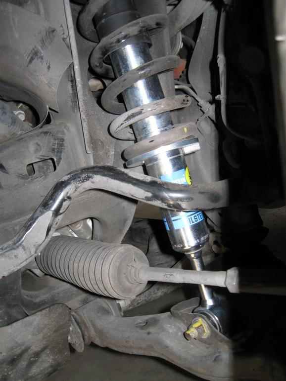

Finally got my new toys and already adjusted the Circlip to the desired lift but I'm curious if there's any special that needs to happen between the Circlip and the Coil/spring seat.
The Circlip moves in the groove but not sure what needs to be done with the coil/sprint seat when it inserted in the shock :ybrick:.
Thanks
I just got mine too. I find it amazing that the little clip is holding up the whole front of the vehicle up.
I know Bilsteins are well engineered, and well tested. But did this make anyone just a little nervous?

competed the front lift and I notice that the ride is better compared to the stock shocks. Here's the before and after measurement for the front lift. Will be doing the back lift when the back shocks is available.
Also, I notice that the DS and PS have different measurement before and after the lift. Is this normal or do I have to do something.
--> before
Driver side: 32 5/8''
Passenger side: 33 1/8"
Front bumper: 15"
--> after
Driver side: 35 1/2''
Passenger side: 35 7/8"
Front bumper: 18 3/8"
