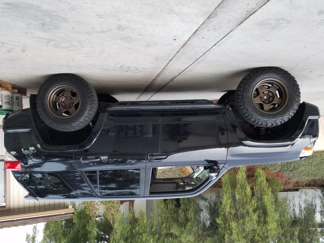

do u have a pic of what you went with on the .85 bilstein
sent from my iphone using tapatalk
Sorry upside down lol I don't know how to fix it
