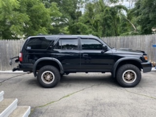

It was put in a while back with the 4Runner talls and I had to use a 1.5 spacer in the rear to level, had a rear wheel bearing take out the axle and order a set of the 906’s to eliminate the spacer. Has a bit more rake at the moment than I’d like. Picture not gonna do much justice.
I think the factory spring is in on the second perch. I will lower to perch with the OME.
Also gonna add a shrockworks front bumper. Should I do the 881 with that?

just measured I'm at 23 3/4 in the rear with 906 OME and 21 1/2 in the front on the factory 4runner tall spring measured from hub center
