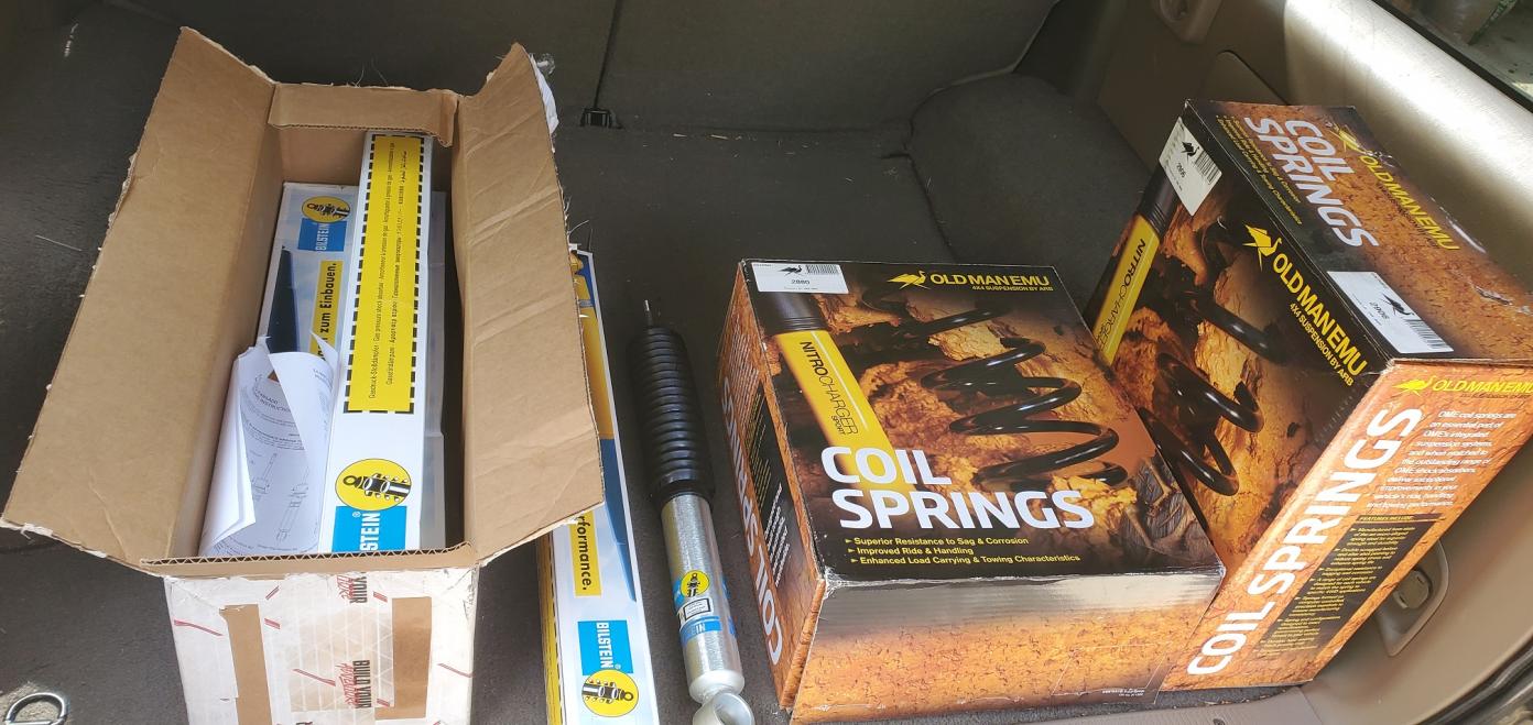

I decided to go with the 5100/OME kit. Got the discount deal currently offered on line here: 1996-2002 3rd Gen 4Runner 5100/OME Lift Kit | SRQ Fabrications
Seemed reasonable to me, even though I know there would be less expensive approaches. I'm not a mechanic, and really only try superficial work myself - so I was more comfortable going with a common "kit" and having my Toyota dealer do the install. $650 including front & rear alignment. So $1400 all in.
I was sold by the "why not" thread linked above here, and here: Why not OME 880/906? Talk me out of it.

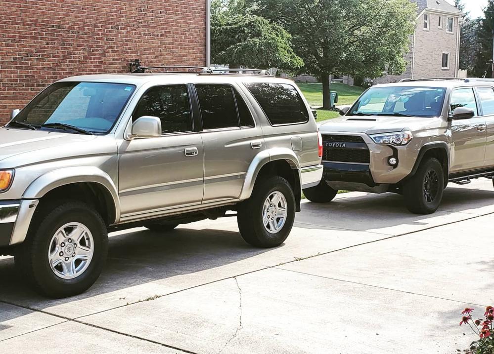

Looking forward to getting it done, with the understanding the stance will be pretty close to the highest stock year ('99). I met another guy who had the same kit, and his was sitting about the same height as my '16 TRD PRO (which I think is perfect). I don't have any concern about how it is going to go - but will of course make sure the shocks are set right.
I'll add some before/after pics.

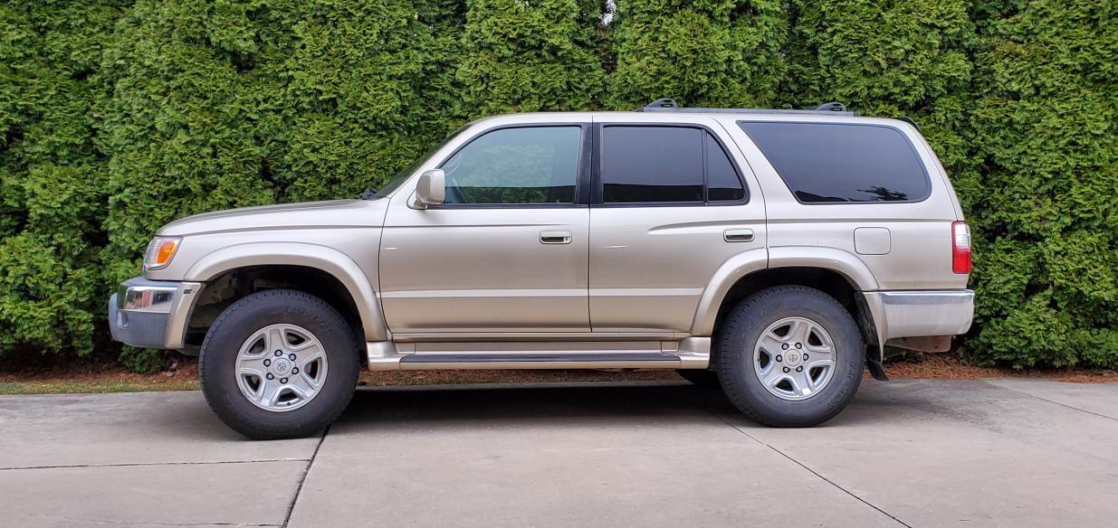

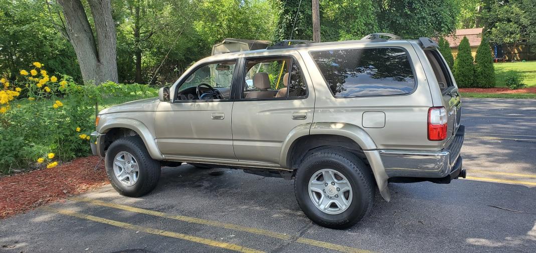

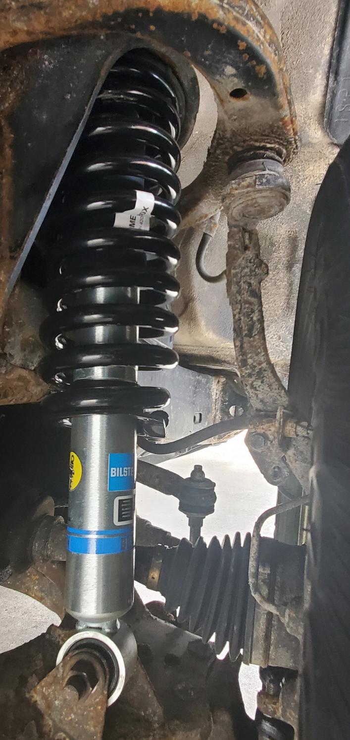

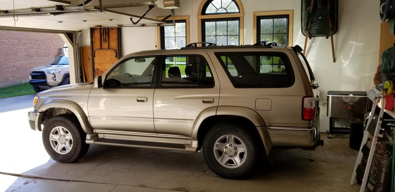

Hey Dennis - did you get yours done yet? I just did last week. Also had the ball joints and top plates replaced, as well as some bushings. I also had the tank skid replaced... it was rusted through, while the entire rest of the thing underneath has only superficial rust in a few spots. I had Dunning Toyota in Ann Arbor do it all. They were very reasonable, and I really trust their experience and thoroughness with the alignments.
So the thing now rides like it's brand new (or as good as my '97 did when it was new, and that was the only T4R I've bought new). Maybe only *slightly* stiffer, and also more of a feel of control. I'm very pleased. It isn't super tall - I think it is perfect, and about the same height of the stock TRD Pro. It has a slight rake which I actually like and that's fine because it is often loaded. I do plan on picking up the slightly larger tires with some more off-road worthy tread... maybe later in the fall, as the current ones aren't in quite a good of shape as I thought.
For the record, the front was lifted about exactly 1.5 inches. The back about 2.5 inches. That's probably the most anyone would see from these springs and shocks on the lowest setting. But it's just a function of the 2002 being the "shortest" 3rd Gen T4R in the first place, combined with the back REALLY sagging. The pictures I shared were with it empty. If I had any load at all, it was pretty brutal. I should look for a picture with it loaded down with all our snowboard stuff & packed to go up north. It was kind of embarassing. lol
Attaching some before and after pics. Also in the album I shared.
