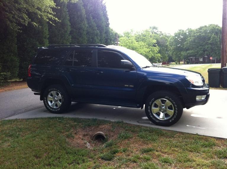

Here's one quick pic taken on the drive home this morning I doubt the street is perfectly level. This is at .85 setting with FJ springs all the way around. I am currently sitting at 1.5" rake but I've only put about 40 miles on it so far (2" rake stock). How much did you guys settle out if any?
What do you think? Do I need another inch up front?

I think it looks good just like it is! From the looks in the pic, if you go up anymore in the front, I think it would look nose-high. Keep it like it is! It looks good man!
Looks good to me. It should settle some, which may help (depending on if it's the front or rear that settles). Take a jack, put it under the front, raise the front 1" and look at it. This will give you a good idea of what's needed. Only other option would be adding the Toytec 1/4" thick spacer to the front. This would be relatively cheap, and hit right in the middle of what you currently have.

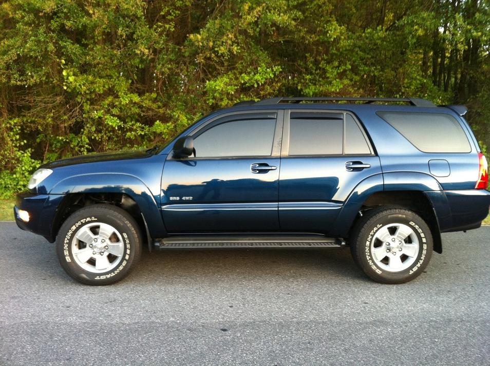

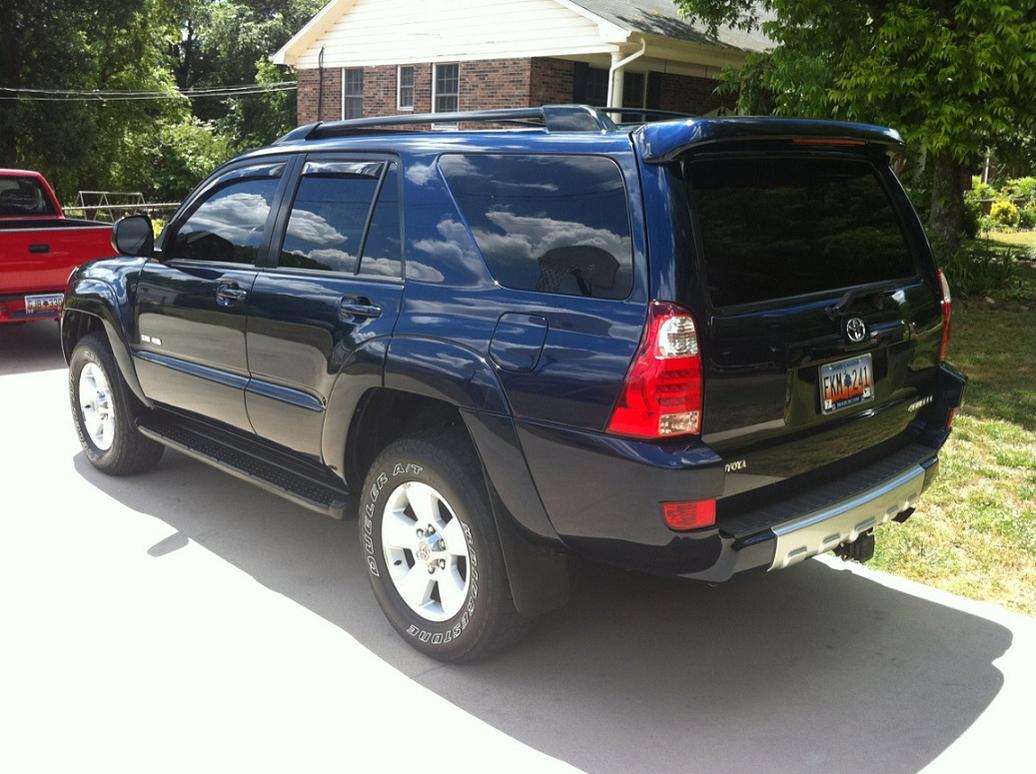

Not to sidetrack, but my current setup has 1/2" rake. Here's a couple pics to give you an idea of what that looks like (mine is 5100's front on 3rd notch with FJ springs, lifted rear with air bags).
IMAG0128.jpg~original
IMAG0127.jpg~original
I think it looks good! Measure from the ground to the running boards, front and rear, to determine the rake. The front and rear fenders aren't identical so it won't accurately describe your stance.

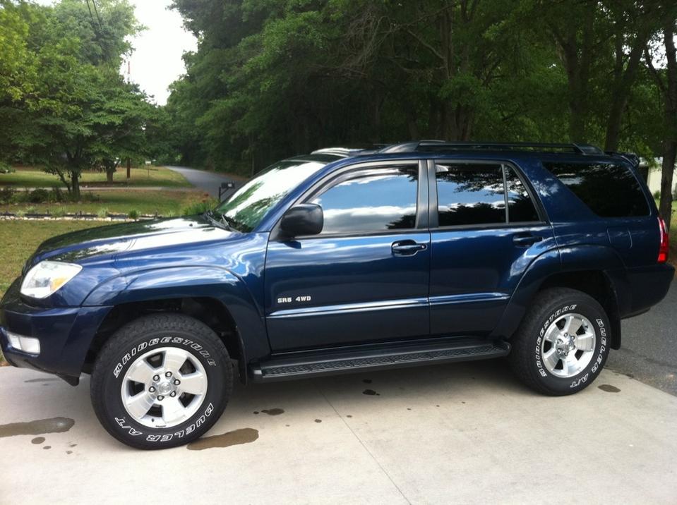

Here's another quick pic from work. This one is about 3 days old on the lift. Maybe 75 miles on the springs. This weekend I'll be buying tires and spidertrax spacers. Tires will either be 265/70/17 BFG A/T or Bridgestone Revo 2 A/T.

Truck is looking nice! I don't think front or rear will "settle" by much, if at all? The latest pic you took does make it look like the front has a bigger gap between the top of the tire and the wheel well. I find that to be true with some of the pictures I took of my truck too - probably just different angles and such. The BFG's you're putting on will fill up the wheel well some too.

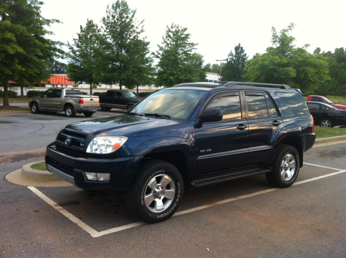

All pro spacers in the mail. Just picked up these tires today. Got them used on local CL really cheap. Just wanted to get an idea of where I wanted to go next. Bridgestone Dueler A/T Revo 2s 265/70/17
**NO scrubbing issues at all

Sweet looking rig. I love the color. Your springs have the truck riding at a good, level stance. The spacers add a lot to the looks.

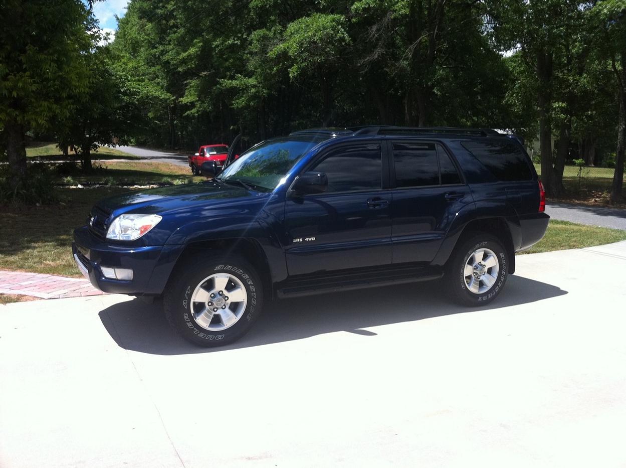

Tried out some Eagle 1 Nano wax. Easiest wax job I've ever done.
