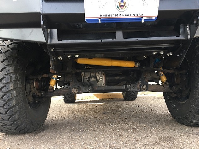

Bilstein yellow HD's
I'm running the regular Bilstein HD yellow shocks front and rear with 2" blocks in the rear and cranked torsion bars. It's a night and day difference. $300 shipped on ebay. The 5100's are for a 4" lift or larger.
pics
Running 285/75x16's with no rub on cranked T-bars and Bilstein HD's
