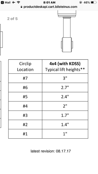

Here’s the updated KDSS and Non KDSS settings
hmm i definitely did not get 2.7" of lift. Gonna hit up the 7th setting though soon as i get some DirtKing uppers.
Loving the 6112's for what we use the van for....wife daily driving for work, and occasional camping trips:hippie:
I’m guessing you have KDSS for the 2.7 setting.
I just installed mine yesterday non-KDSS at 1.6 and it’s pretty spot on. I put Dobinsons 599s in rear and got 1.75” of rear lift and should only be 1.25” before settling. Hopefully rear settles at least 1/2”. Only wanted the 1” rear lift.
These 6112s ride so much better on these crappy Louisiana roads, body roll is better and the nose dive is much better and feel like it’s a lot more stable during hard braking.
yea, maybe its at the 2.4 setting though. i forget what i put them at lol
