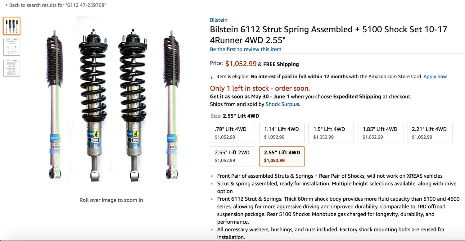

So I haven't seen this info on here or on the internet anywhere in my searches on the 6112's for 5th gens, but I came across it in an unexpected spot...Amazon! So I thought I'd post it here just so it's out there for people to reference. I hope it's somewhat accurate!
It lists the different lift heights for each ring position on the Bilstein 6112's with 7 positions. Hopefully this can help dial in the perfect suspension system!

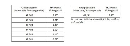

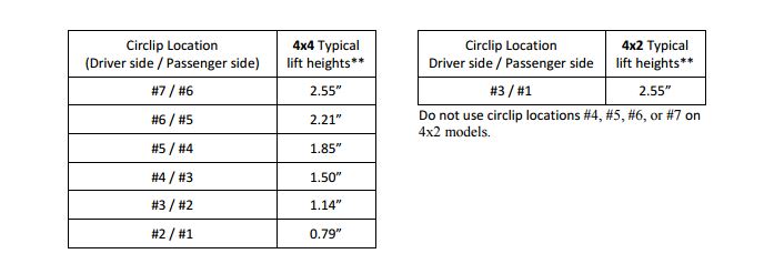

Here is the info on the 6112's with 7 clips. i just installed these (47-259768) on my 4runner and a put them on the 7 and 6 clip setting.
Due to past experience with 6112's, I'd be leery of the Circlip settings for those lift references....

I can attest to the inaccuracy of the Bilstein estimates. I had mine installed at 4/3 and got less than 1/2". Going to pull them and reset to 6/5...

I've got first gen 6112's and the listed heights on their literature is lower than what is achieved when installed.
On the 3rd Circlip, I achieved a 2" lift. IIRC they stated something less than that...,maybe 1 1/2".

I have mine installed at the 7th clip. Got exactly 2.5" in the front. Beware if you have a kdss equipped 4runner. The instructions are misleading. I had mine originally set at 7/6 as per the instructions above, but ended up with the passenger side lower than the drivers side. At equal settings, the truck is balanced side to side (or at least within 1/4").

With a KDSS 4runner, couldn't you just install clip 6 on the drivers side and clip 7 on the passenger side?
you could but i got mixed reviews. some who did that experienced as much as an 1inch lean with a shim so maybe 1/2-3/4 without? others didnt experience any lean or some who did but recalibrated the kdss system.
i said f it and did it both at 7. my lean is probably just 1/4 judging by my fender to center measurements. not dramatic at all. so im assuming when i installed i compressed the kdss somewhat correctly?
oh and also bilstein never had instructions which clip to use for the kdss system at the time of install. i installed back in '17 when the 2nd gen of the 6112 was released? i think thats when it was released. 5 clip vs 7 clip.

So I’ve got 6112’s on a 2x4, and I went with Bilsteins recommendation and used the lowest clip setting, but I definitely didn’t get a full 2.55” lift. Still getting some rubbing at close to full lock, so I’m trying to figure out what to do from here.
Does anyone know why Bil says to only use the lowest setting for 2x4? What could happen if I went higher? Would it negatively impact the truck’s stability/performance? And if so, how?
If I do go higher than the recommendation, would I need to change out the old c clips for new ones?
And if I keep it as-is, could I add some spacers to achieve my desired lift or would that have the same negative impact of going to a higher setting on the 6112’s?
