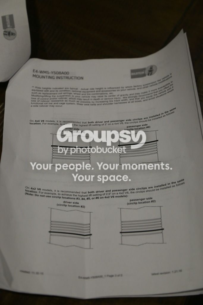

Hi All, Trying to get clarification on the 6112 installs on my 2005 V8 4runner 4th gen. I'm trying to avoid driver side lean. I see plenty of post on off setting the snap ring. Not sure if i received a new version of 6112 but my instruction shows specific detail for V8 to match the snap ring position install. Anyone follow this instruction on the V8 and not get the driver side lean? I also plan to install the 5160 with toytec superflex that should give me a 2.5 lift. thx in advance.

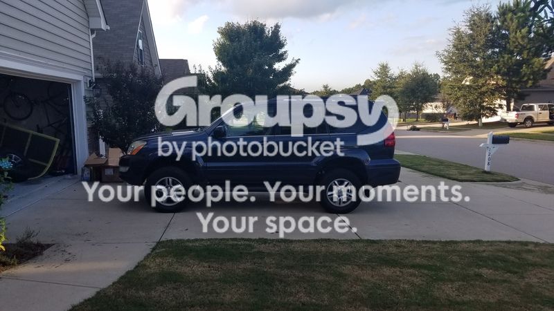

I am as close to a clone of your setup you can imagine. I have a 2005 gx470 (exact same thing as V8 4runner). I just installed bilstein 6112s on the front and 5160 with toytec superflex in the back. I followed the instructions and put both sides at the top clip and there was no driverside lean. Also, I put a 10mm trim packer (spacer) on the drivers side in the rear. Still no lean.

how did the stance come out after the install. I'm hoping for level to slight rake in the front. i was going to do 2nd ring from the top or 5th one hoping the 2" superflex in the rear level it out. I think 5th ring supposed to give me 2.68" lift according to instructions.

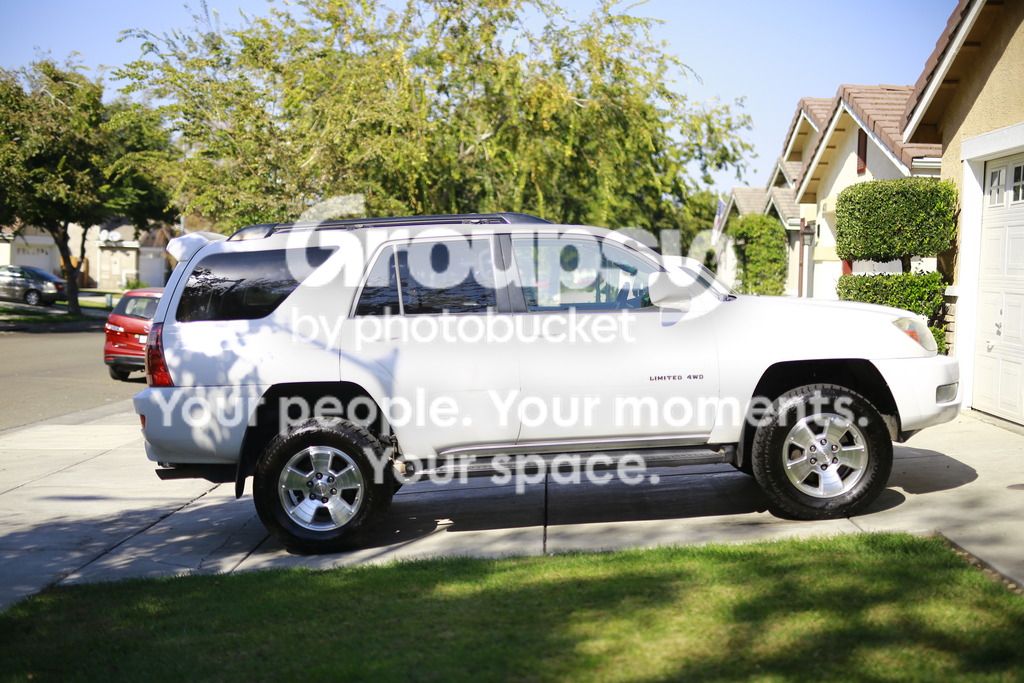

I went 4/2 on mine with the V8. I like the stance and didn't want to get much more lift. It has a little bit of forward rake, but I don't mind it and it's far better than stock, in my opinion.

I like this.

Did the instructions that came with yours say to match the clip ring for V8s? curious to know if I got a new version w/ new instructions.

Oddly, no. All mine came with was V6 instructions. So, I just added one ring to their instructions to compensate for the V8. I like how it sits and how it rides. It's definitely way better than stock.

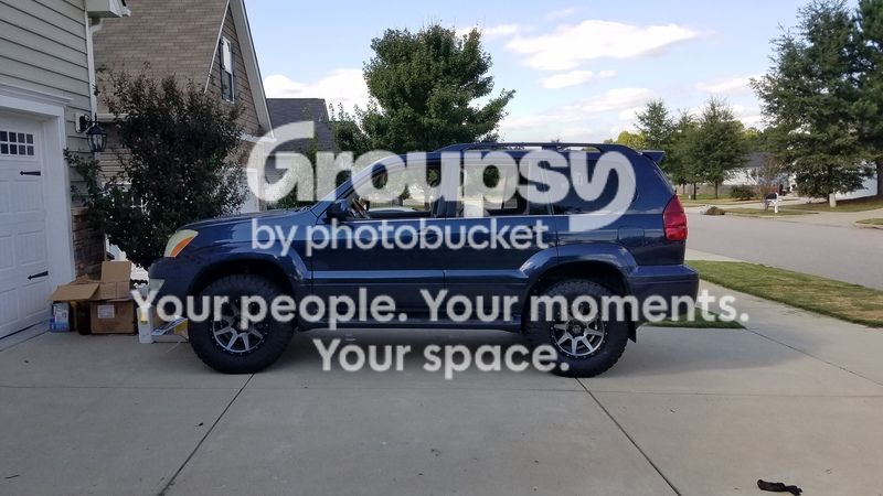

Got them installed.
did the 5th ring on the 6112s. thought i had a major rake but it settled a lil more after a freeway drive. definitely would need UCA if i went to the top ring. went to get it aligned and noticed they put in some work to get it to spec. all is good. ride is great!
